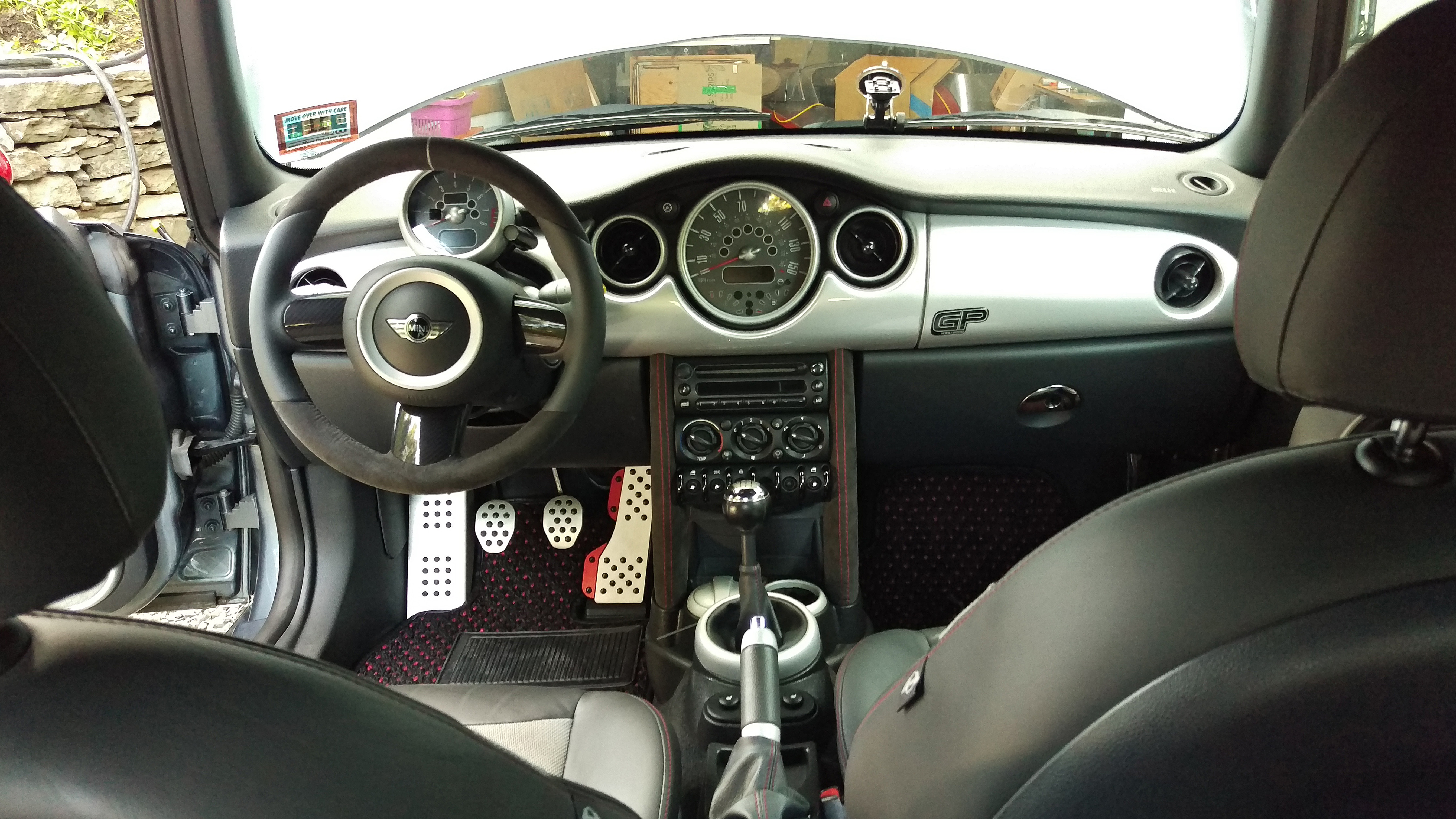

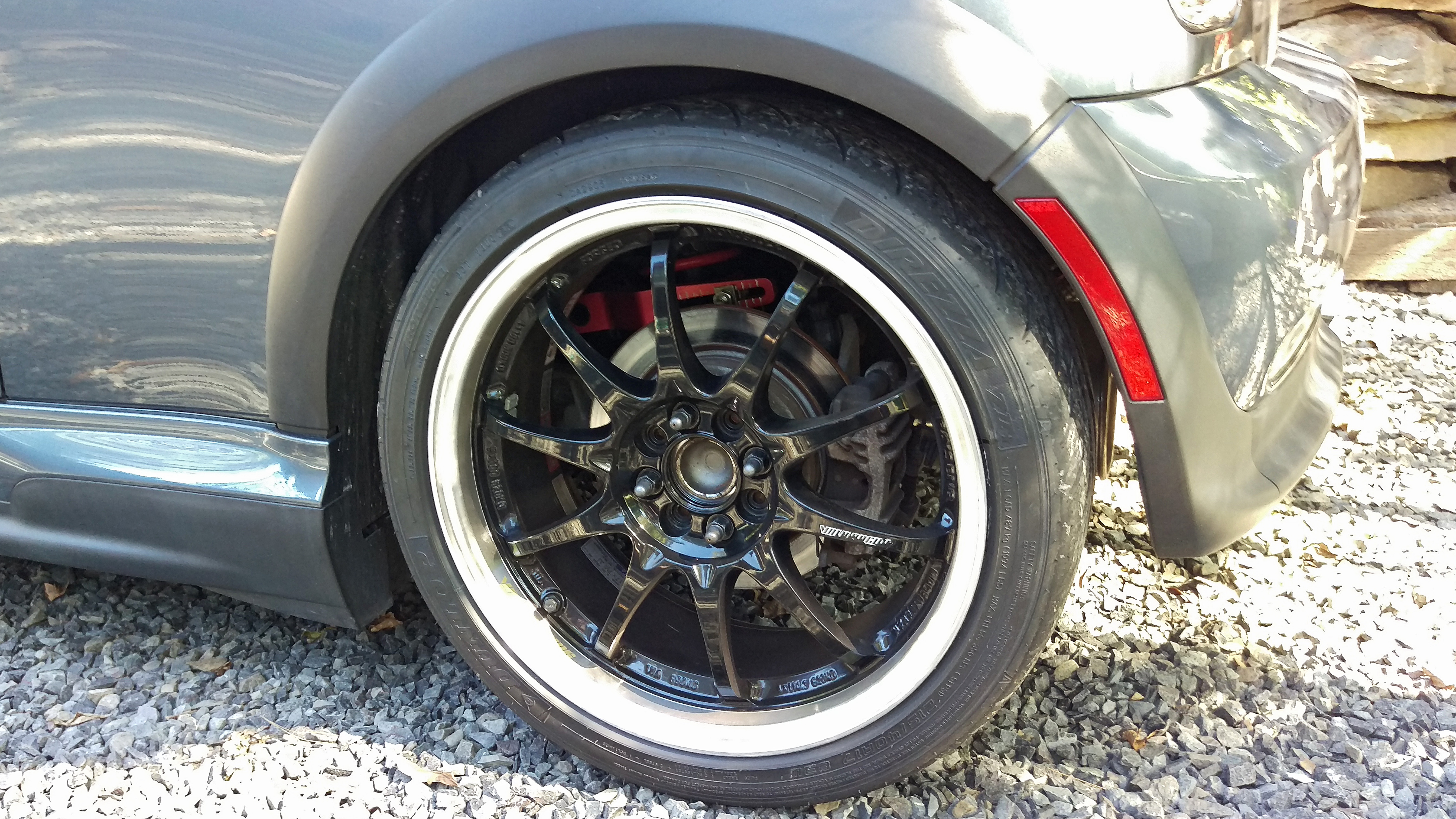

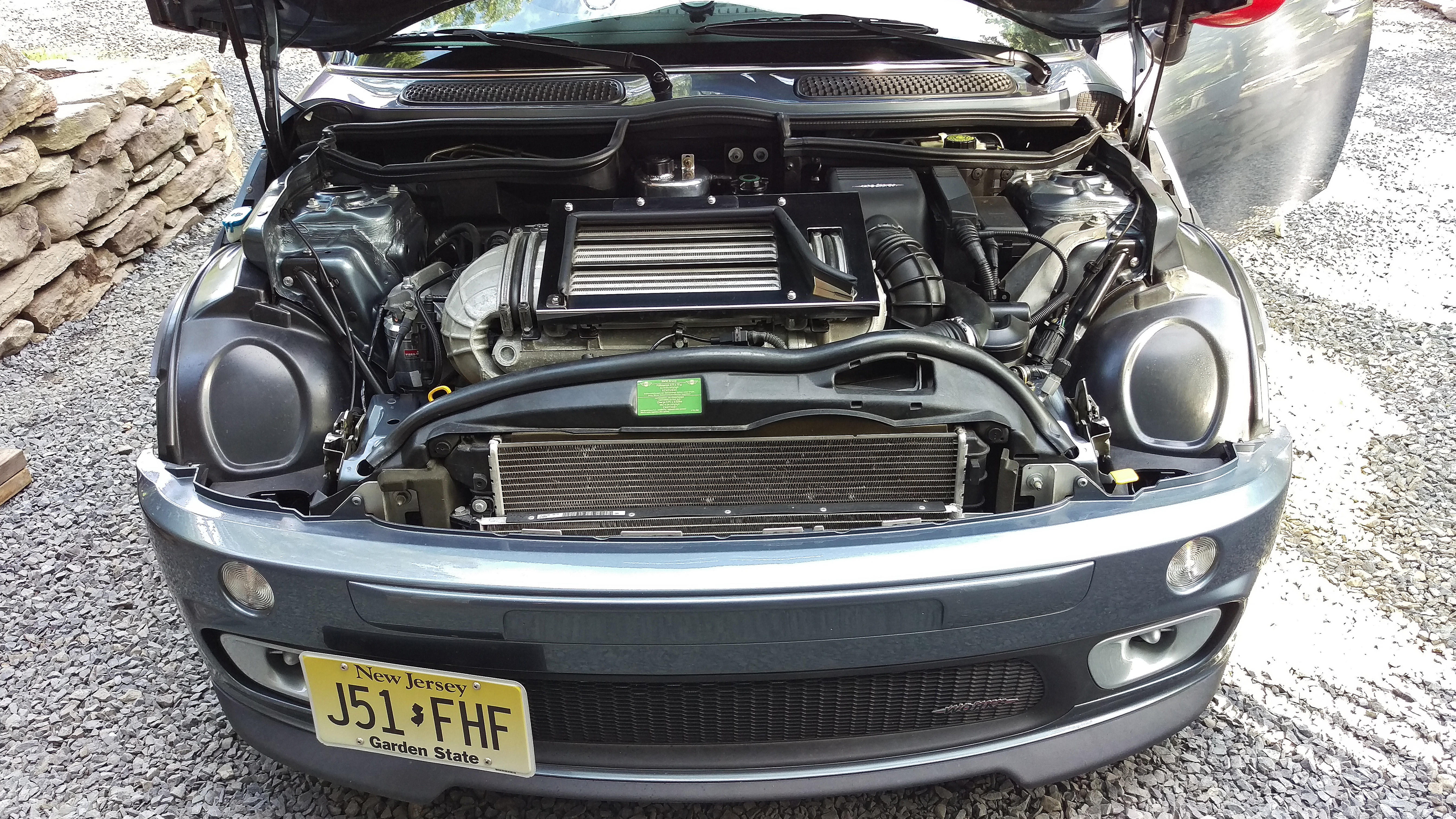

It's been a long while since I posted here, so thought I would report my progress so far. Goal for this season was to do at least one autocross (to gain some comfort with car and because thats what I know best), followed by at least one track event. Well I had to cheat just a little to get both in…
I took my Audi S4 daily driver to a NASA trackday at LRP when I realized the GP wasn't going to be ready modwise again (and still felt important to do an autocross first). After more scrambling to finish things up, GP1489 finally made its autocross debut last weekend - and I was very happy with how that went.
Current list of attached non OEM stuff:
- Volk CE28 17x7.5 wheels (14.25lb/ea)
- Dunlop Direzza ZII Star Spec 215/40-17 tires
- Turner Motorsports wheel studs/nuts
- H&R 5mm spacers
- Tarett 23.8mm hollow/splined fully adjustable RSB with drop links
- Madness JCW air filter and ‘flap mod’
- DDM GP I/C air diverter (ss polished to not look like a kitchen appliance)
- Forge aluminum coolant tank
- RMW ‘shorty’ header with Swaintech coating
- Craven 15% pulley
- RMW tune
- BSH lower engine mount
- Vibratechnics ‘Race’ upper engine mount
- Powerflex ‘Black’ trans mount bushing
- Powerflex ‘Black’ steering rack mount
- GT mid (lower) brace
- Cabrio braces, powder coated black
- Proshift programmable shift light
- Rennline full pedal kit with custom positioned dead pedal support
- JCW/Alcantara steering wheel with radio/cruise control delete
- Alcantara covered ‘downtubes’
- ‘Auto-up’ window and DSC defeat memory circuit
- Osram Rallye 65W headlamp bulbs (x4)
Mods acquired but still in queue for installation:
- KW Clubsport coilovers with camber plates
- RMW ‘Dominator’ cam
- RMW sourced 550cc injectors
- RMW sourced oil pan baffle with ‘trap doors’
- Brake cooling duct ‘kit’
- Magnacore wires and Brisk silver plugs (didn’t realize I/C had to come off)
- Schroth 6point belts (waiting for seats and half cage)
Data acquisition stuff acquired and figured out with only a moderate amount of brain damage :
- VBox Sport with external antenna, Bluetooth
- Kiwi 3 OBD2, Bluetooth
- GoPro Hero3+Black, Wifi
- Harry’s Lap Timer on Ipodtouch5 wirelessly receiving all three above
