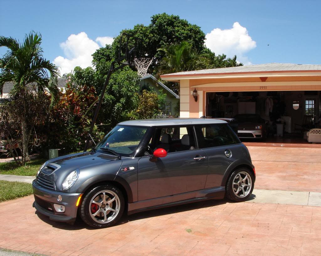

here are 16's advan rg2 with 215/40 16 if i remember correctly
