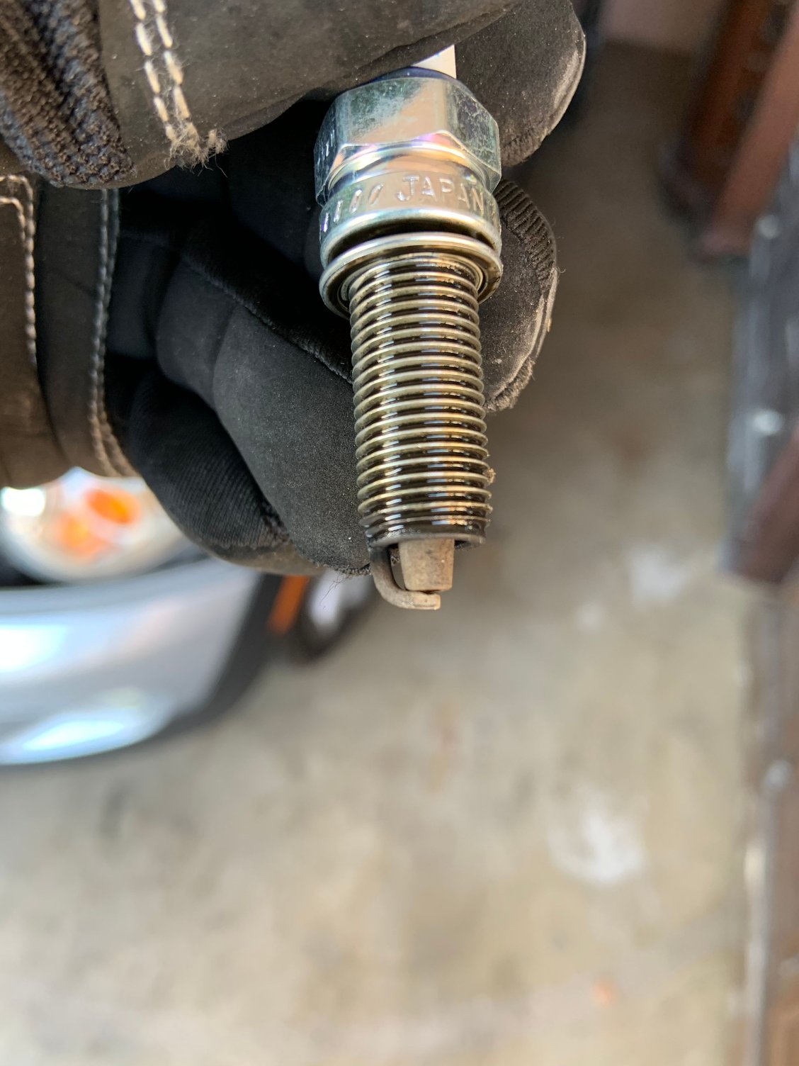

I think I found the problem. Brand new NGK spark plug broke. Covered up the tip of the spark plug.

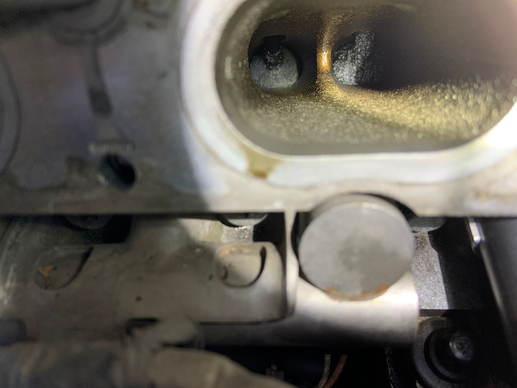

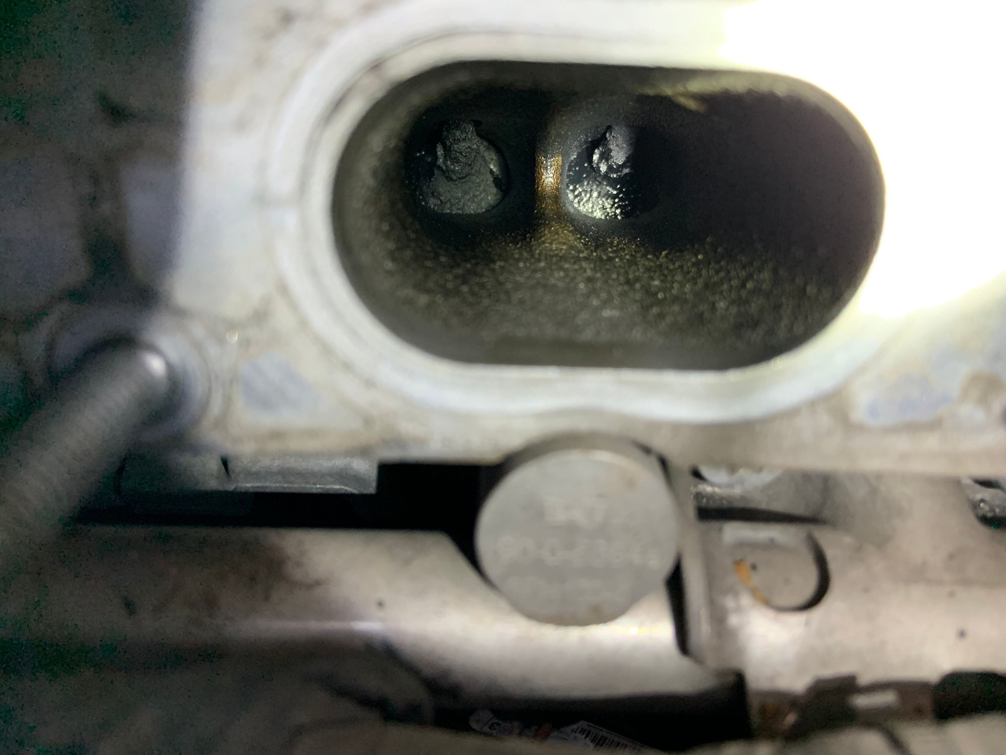

Took the intake manifold off. My valves are awful. Completely caked in carbon. I’ll be getting dirty today.
Hopefully, the combination of these two things help with the idle and overall performance. I’ll report back.

wow, fixing those 2 things will absolutely make a difference. how was that plug even firing? is that a NGK 1422 plug?

Yes, 1422 NGK plugs - brand new. The inner part just came loose and was rattling around in there. I changed the coil pack on that cylinder bc I thought it was the culprit, not realizing it was the plug. At least I wasn’t going crazy. I think as it rattled, sometime the spark would actually ignite the fuel.

All done. It’s like a new car. Idle is smooth and even with or without the A/C on. I seriously thought it had stalled at a traffic light it was so quiet and smooth. Breaks the tires loose through first and second again!!! Glad I took the time to scrub the intake valves - what a pain in the butt. I cleaned one of the old plugs and reinstalled it. Put the old coil back in too.
