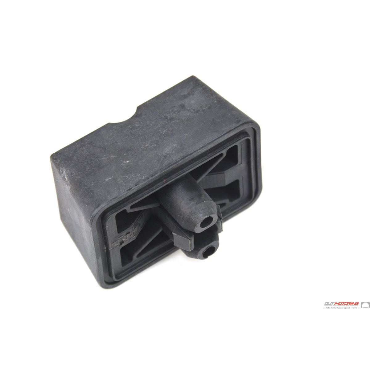

Ther's a "pin" in the center of the jack block , that when you install the blocks the "pin" is pushed up into the block spreading apart some "fingers" that lock the block in place. You can pry the pins down and out to release the block from the car. Might be easier said than done

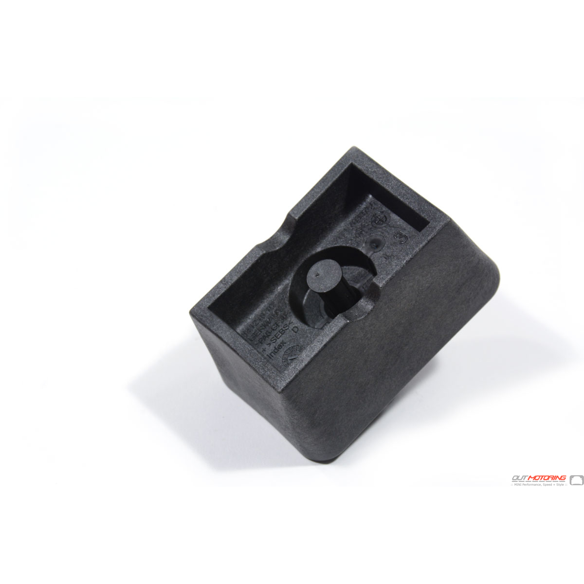

Helps ... maybe? The 'center pin' spreads the tabs you see here ... pulling the pin 'up' releases the pressure on the tabs but may not release them entirely depending on age .... but a trim tool can solve this . . . You can see what you are working with . . . essentially a snap in part.

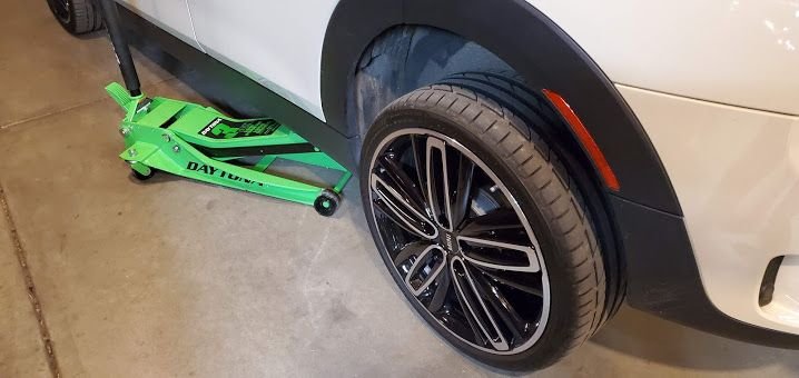

I just got my MINI, I have the Detroit Tuned F54 jack which fits perfect in the block and I also have a massive 3-ton Harbor Freight Daytona floor jack. I didn't lift it all they way but I was curious if I can also use a floor jack saddle right on the rubber blocks as they are and lift or is there a better place to put the saddle ?

I personally would line that jack up straight in. Since I have 2 blocks I line my cup up with them. For the other 2 depends on what I’m doing. 2x4 in different lengths depending if whole side or just a corner, has worked for me for years and I’m comfortable with it. I switched out my mini jack for a much beefier scissor style the I’m also comfortable using.
