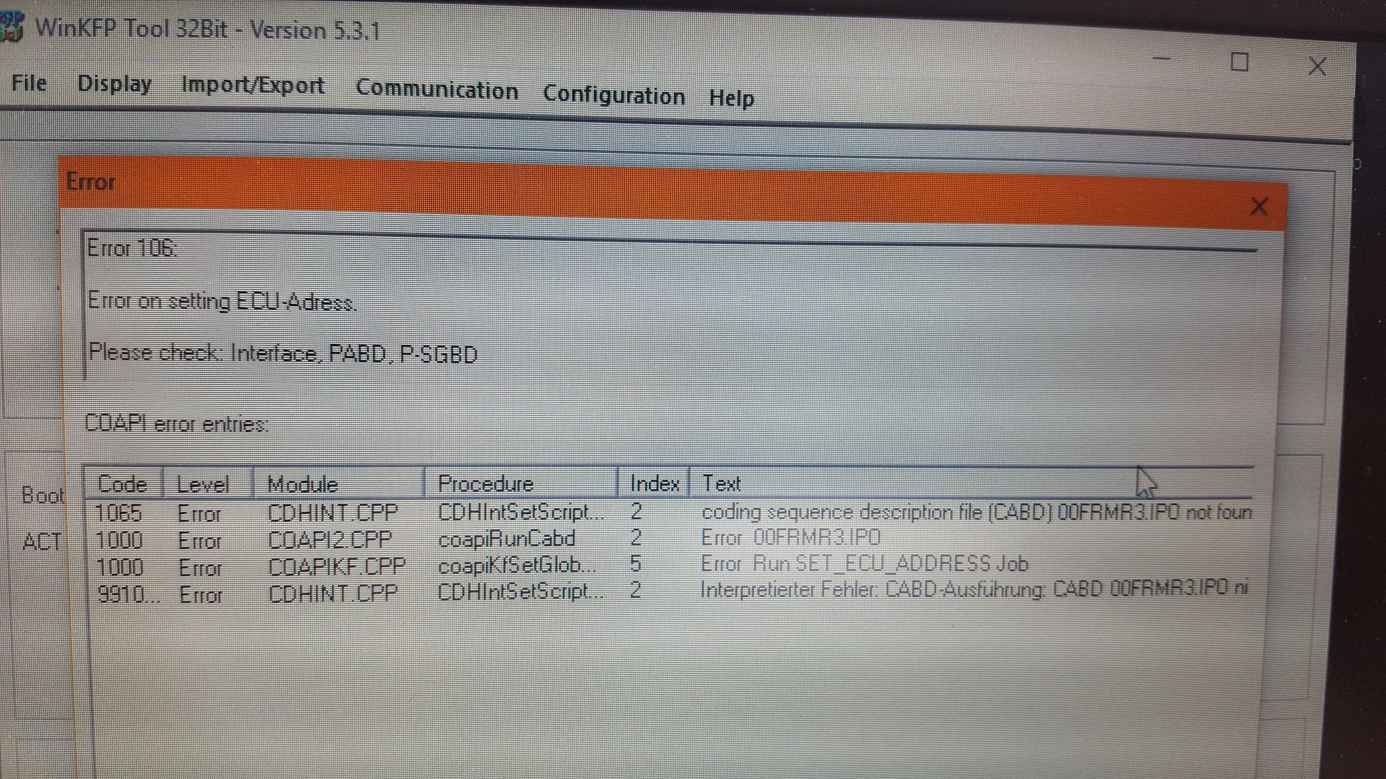

Hello, I'm having issues using Winkfp. I'm trying to code a replacement FRM for my R56. At first it wasn't showing the correct modules, i reinstalled the files via directions i had found around the net. Now its showing the modules, but its giving me a error. I'm including pics of the errors and of my cable. I have noticed i am getting the same error with the cable attached to the car as i am with the cable not even hooked to the laptop and trying the same thing. I was able to pull the VO and VIN from the CAS using Nscexpert. I'm leaning towards it maybe being a cable compatibility issue?

For some reason i never noticed it mentioning that the 00frmr3.ipo files are not found. I'm thinking about doing a fresh install?

If you loaded up the spdatens then you should be fine. In some cases, I used to get this error too. since my goal was updating the module, i would just go to update and select the module i want. We could do a teamviewer to run though the issue.
For the FRM, you need to write the VO with NSC (fA_schrieben) and the do SG_reset.

OK i did some tinkering today with no luck. I think i have everything installed correctly. Here is a video of my trying to do what you said you did. Either something is wrong, or its the user lol. After freezing my hands off (no heat in my unattached garage) i gave up. I even tried to enter the zub in from my frm3 since mine wasn't on the list. So is it possible that maybe the replacement FRM isn't compatabile? the real oem site confuses me.
After all of the fighting trying to get this to work, i searched my computer for the 00frmr.ipo file that the orginal screen pic shows that is not found, and no results are found on my whole pc. So is the missing file the issue?

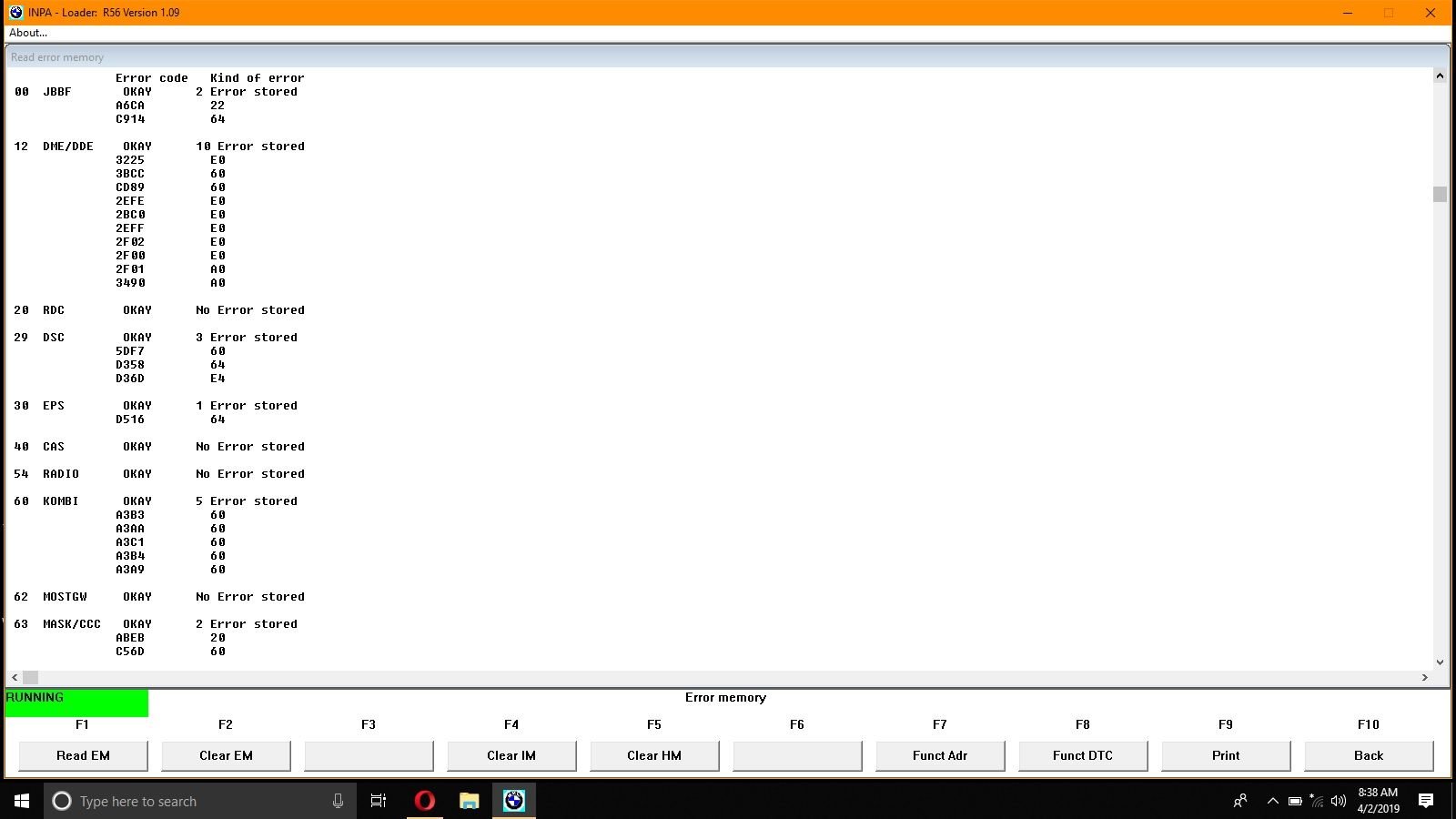

I just looked at the shot you sent earlier for INPA, I dont even see FRM module! the fact that the lights stay on and I can bet the windows dont work is an indication of a dead FRM.

no i can't get it to connect to anything. I can't even pull any info from the CAS with NCS. I was wondering what was going on that it wasn't showing up in the info view of INPA when i got it to connect.

Ok, the CAS is in so it looks like its a issue with my INPA install or something odd happened after i changed the port settings. I will check the settings in the morning when i get home and see if i get a chance to tinker. If that doesn't work i will reinstall INPA and try it again. Another thing to add is i have tried connecting with the engine off ignition on, and also with the engine running. Something has to be going on with the INPA, usb, or my cable,since my other scanner will connect and pull the missfire codes.

Ok i got my INPA working again. Not sure what exactly fixed it but its working lol
