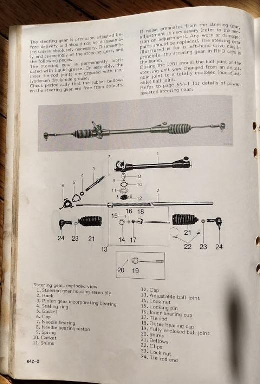

I agree that it can be a total pain to track some of this stuff down - being an old guy (48), I really miss bound paper publications because they're just more easy for me to navigate. It seems all the MINI stuff is digital only. If they do produce paper books I'd love to know about them because I'd deffo get some.
I have a feeling that the Bentley manual is pretty much an abbreviated version of the factory manual, that is usually the case with Bentley and how it was with my old Saab.
Saab had excellent factory manuals.
And also very cool quick reference parts books with diagrams which made it simple to find proper part numbers:
Although I didn't have a 79/80 (mine was an '86), I liked retrofitting some of the older components like roll-up windows and the manual steering rack from '79 EMS because it was slightly quicker ratio than the power rack.
Lovely interface with the manuals. Very legible and easy to read. Nice clear pictures.
