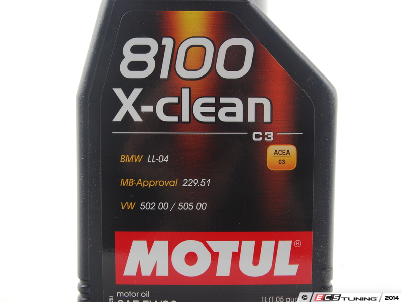

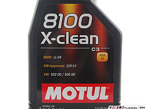

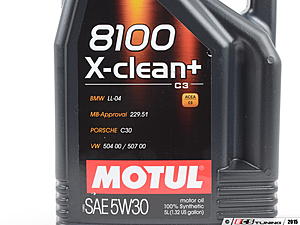

I have used Amsoil signature in the past for years but have switched to Motul 8100 X-Clean+ Engine Oil (5w-30) - 5 Liter because of cost.
Amazon Amazon
I change my oil every 3k -4K in my Gen 1 R53 JCW.
I run a Meth kit and my oil gets dirty faster then non-meth injected cars. I spray the big 1.0 jet with 100 VP M-1 Meth. I have a ViPEC / Link ECU and I have duel maps tuned for Meth and 93 octane or just 93 only.
Inside of my motor top and bottom end look brand new at 105,000 and I beat on my car very hard. That’s what I built may car to do, high HP and able to take a beating. Don’t worry I am very OCD about maintenance. I change oil more than most because of my setup but fresh oil is very cheap insurance when it comes to engine rebuilds with very expensive performance parts.
Frequent oil changes are good for all MINI’s but a must for 2nd and 3rd gen direct injection motors. Also for all DI motors at every 50K - 60k I would recommend walnut blasting the back of the valves in the head since the fuel no longer washes the carbon off the back of the valves.
ECS sells it.
