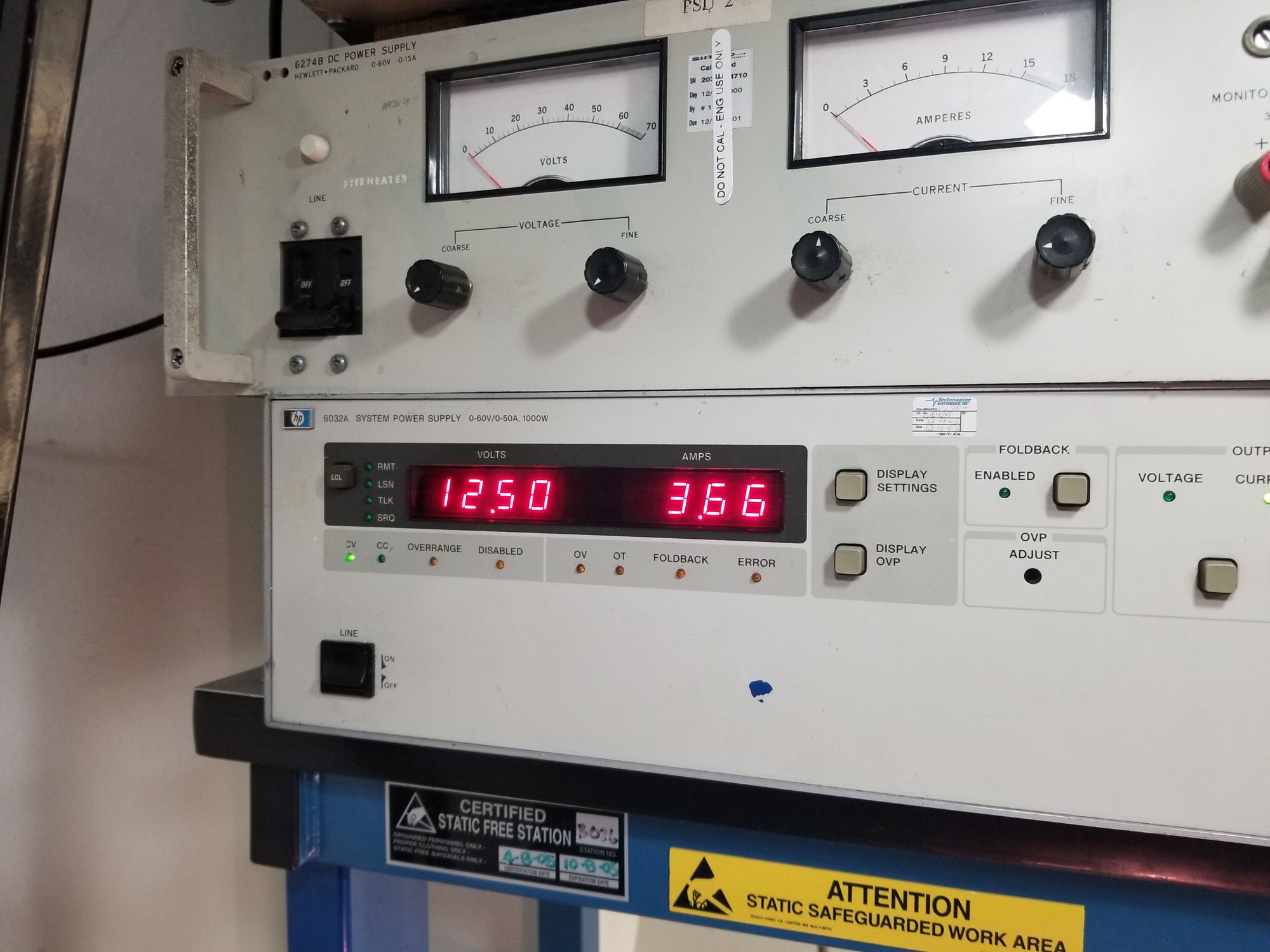

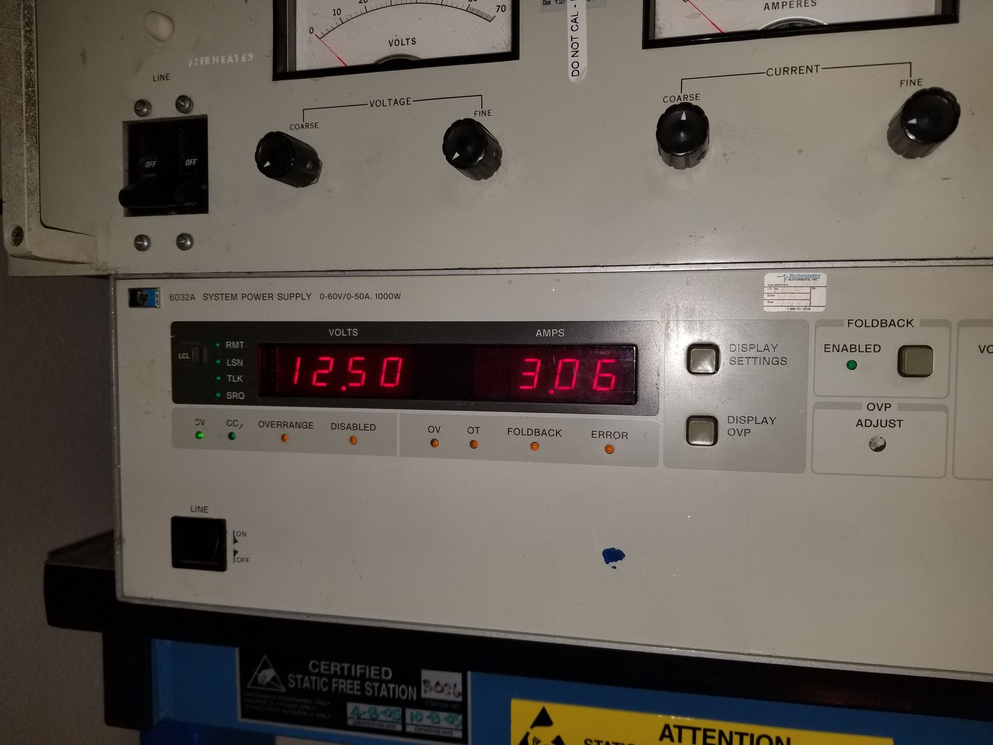

Bulb Advertised Power Consumption Test Voltage - VDC Current - ADC Brightness Cost Notes Ebay 100W 12.5 3.06 0.81 5.99/2 Bluish light due to coating Philips 55W 12.5 3.66 1.00 5.99/1 OEM LED 10W 12.5 0.35 0.45 3.49/1 Bright White, does not fit socket
Pretty similar to what I have observed before - these high power bulbs are usually not close to OEM, and usually do not last. I verified these are 12V bulbs and actually 100W (and its stamped in the base).

Stock bulb consumption
Ebay bulb
