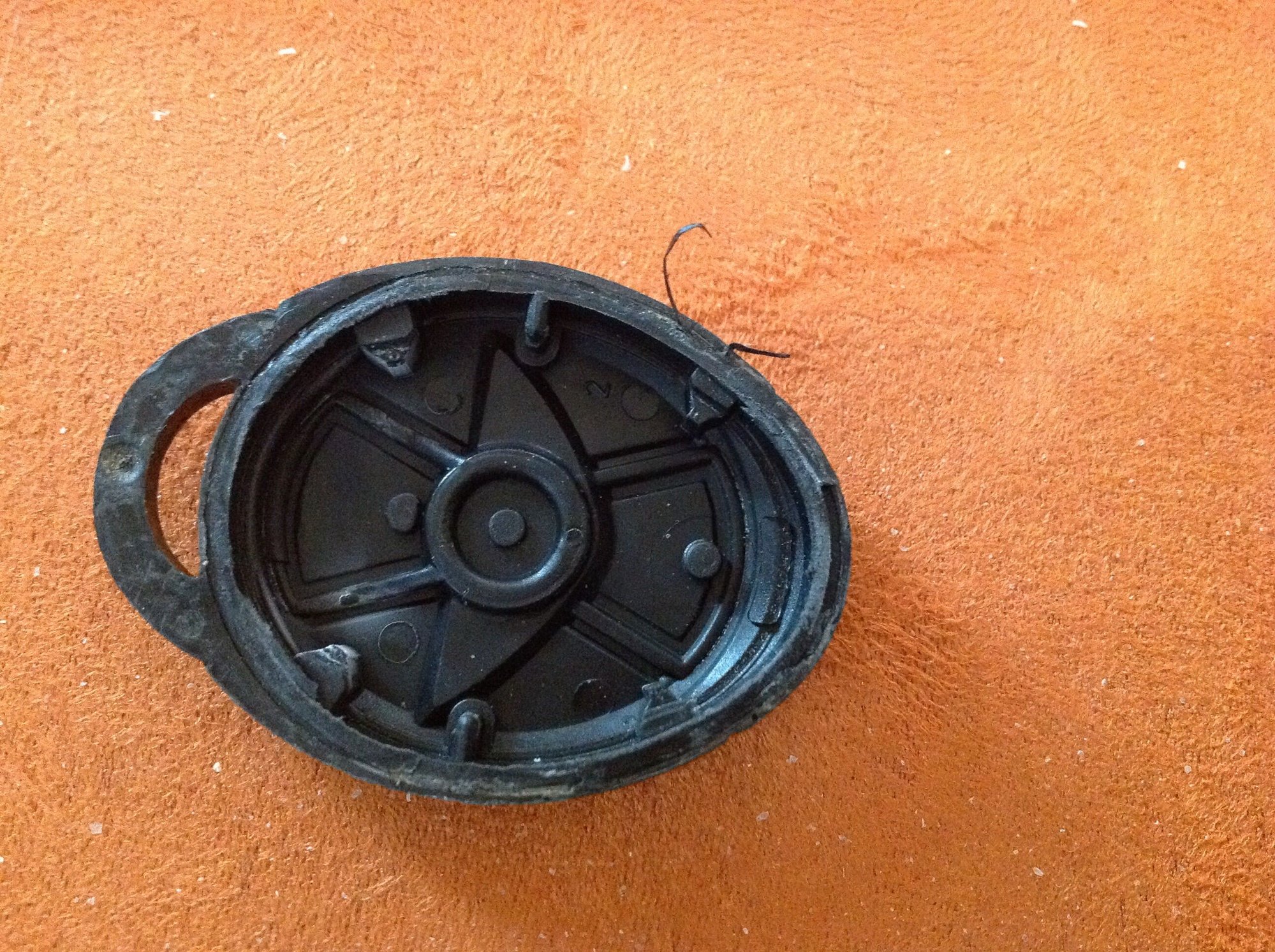

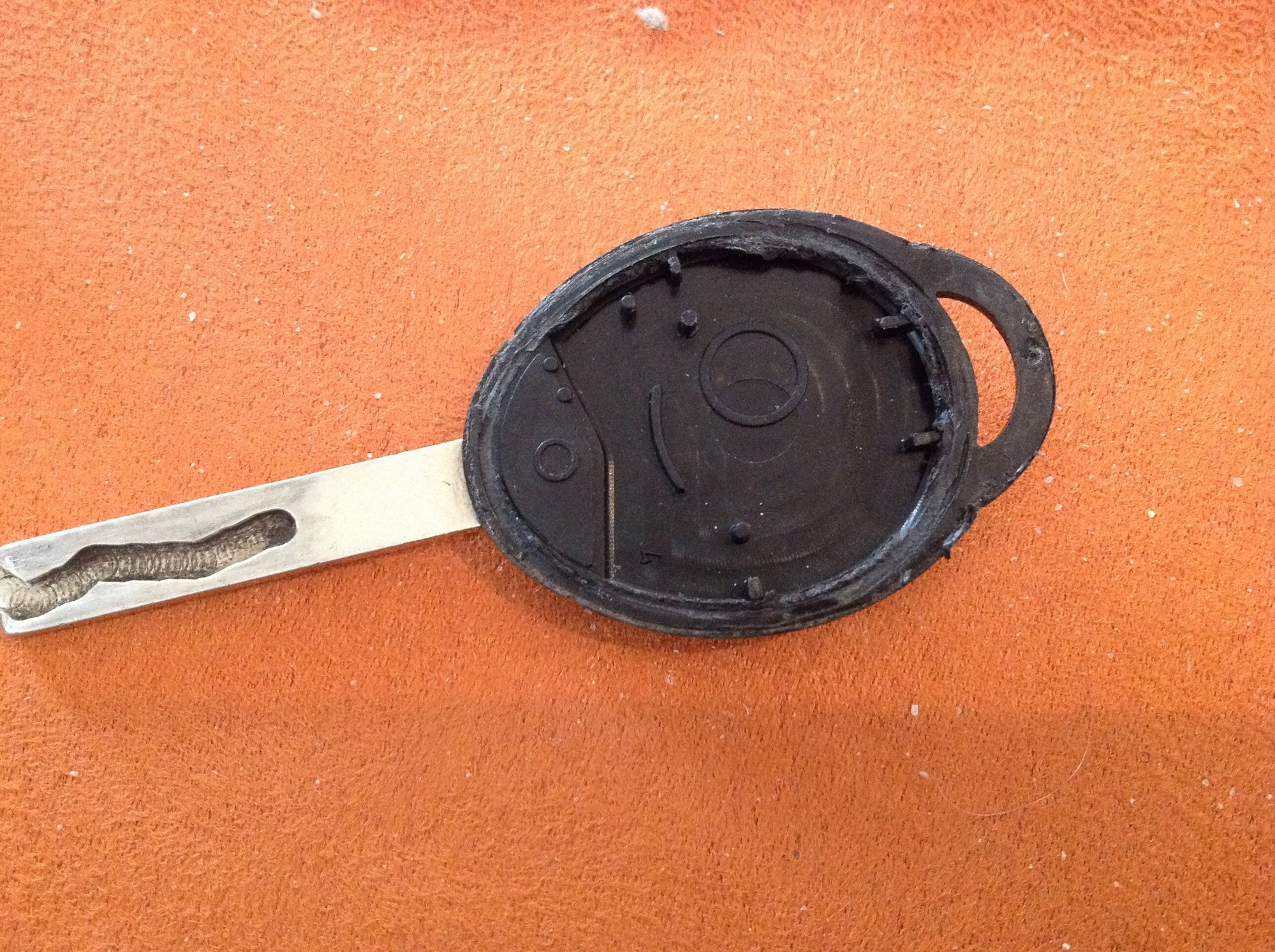

When I insert the key shell, there is no chime, with the door open or closed.
The reason I thought it might be on the circuit board is after I took it apart, but before I replaced the battery, I when to leave, and the car did not start with the key shell, so I took the circuit board and held it close to the ignition and the car started.

Ok, so update.
After reading that other thread, it seems the chip is on the circuit board, but does not seem to be powered.
If I take the key shell, and have the circuit board in the car, when I insert the key, I get 4 chimes, but still no start.
