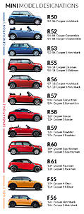

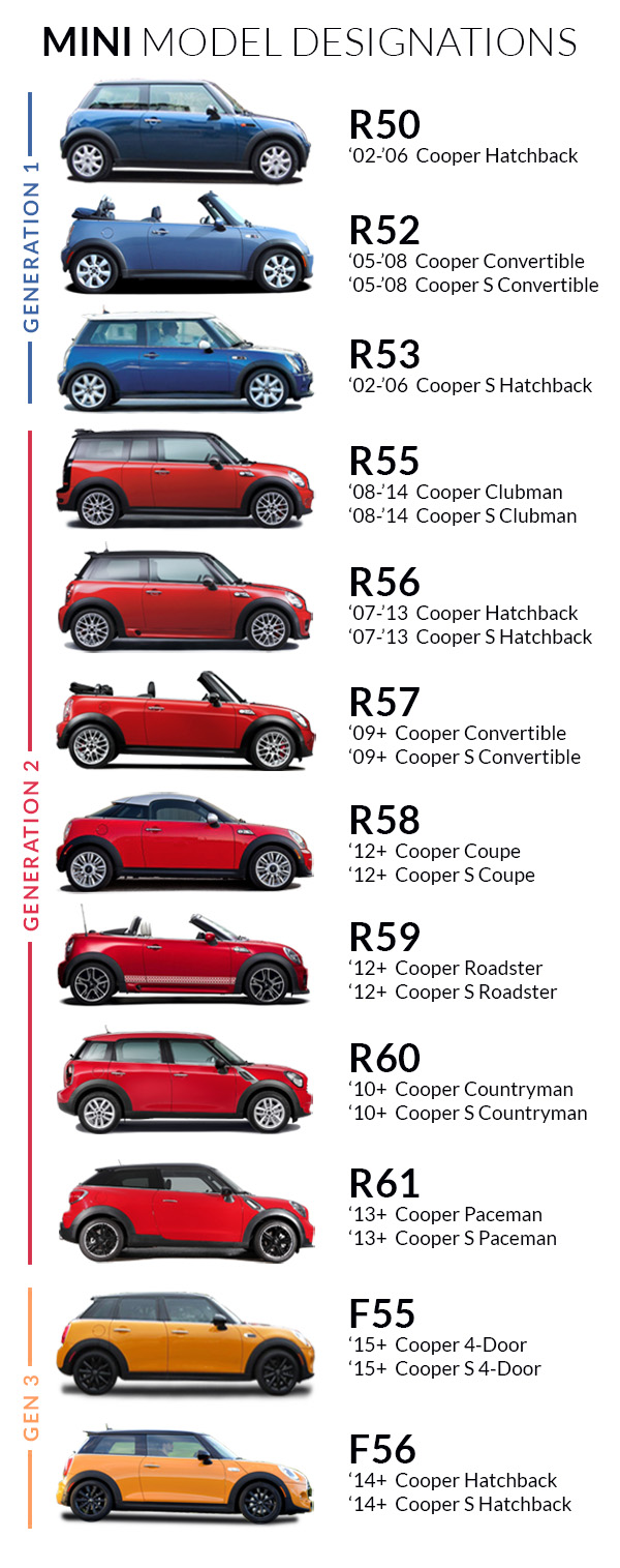

Good chart here: But does not show the engines and JCW models. But gets most of them: The R60 CM started in 2011+ though.
