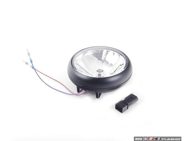

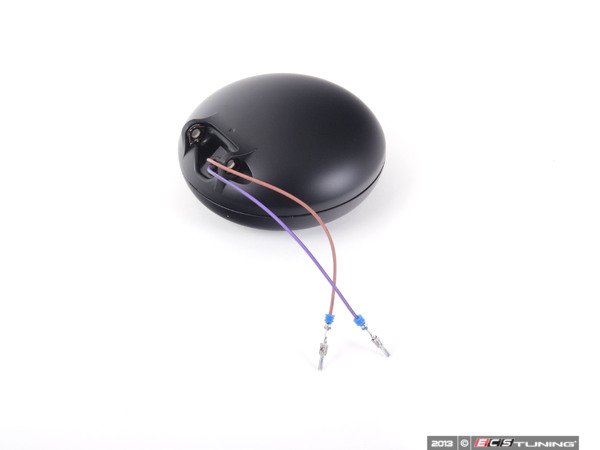

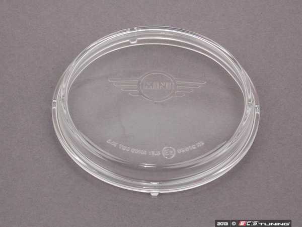

They are sealed beam type( lens to the reflector itself), but you can access the rear housing ( through the rear enclosure). and then through the bulb hole. They hit it with some air from a compressor.
63220432342 You can get the lens separate but then has to be re-glued. .
http://www.ecstuning.com/News/MINI_R...012_2013_2014/
Ralley light itself : Black version for example.
