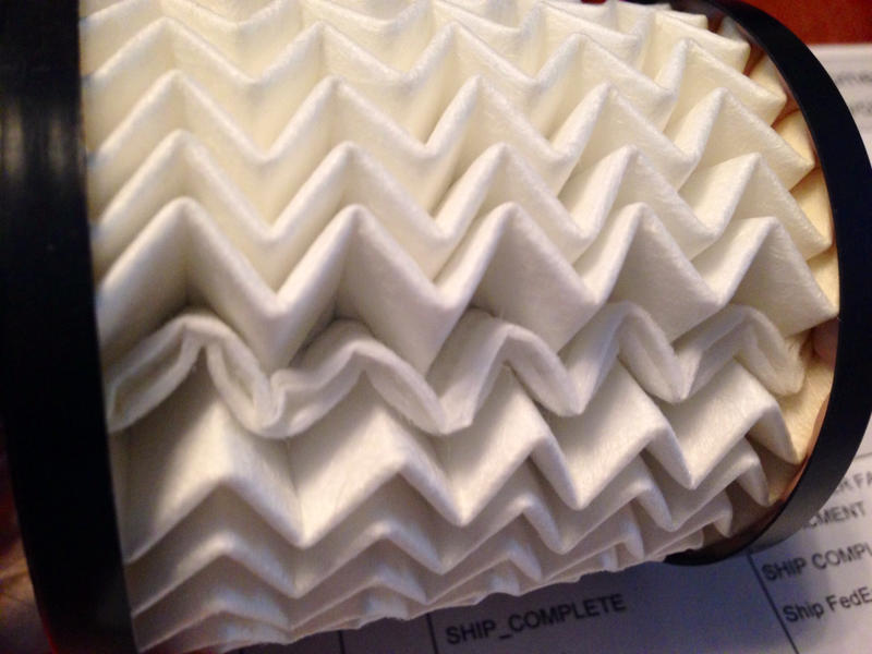

So I just received my OEM filter from MINI Mania (MANN is also coming on a separate order). Opened the box and here's how it looks.
Is it suppose to have two of the elements crushed or recessed like this??

Old Jul 15, 2014 | 12:17 PM
Posts: 36,768
Likes: 2,553
You can see in the pic above the meeting of the according style filter material factory R56+ MINI filter . Its a little on the left, couple pleats in. There will be a little indentation and and offset pleat. I have seen some with a little indentations , and some that are more noticeable.

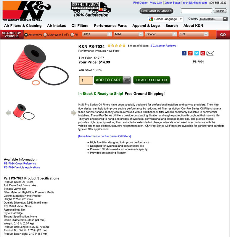

@Afadeev: Does it make a difference the MINI OEM has the plastic ends where the MANN does not? That would lead the inexperienced user like myself into believing the MINI it better.
I followed your filter link and it was most informative. That being said, I checked K&N, and they too seem to have the plastic ends.
Thoughts anyone?
