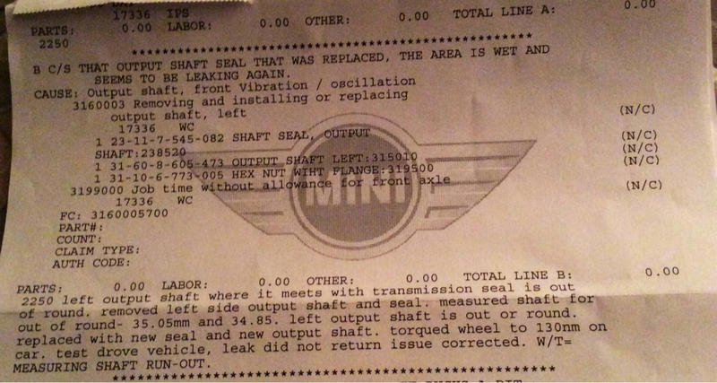

Repairs
Originally Posted by -=gRay rAvEn=-
You had my attention until #3 where fuel additive was put into the mix with the third brand of fuel and then soot was noted. BTW what work was performed by the dealer. Any updates to the DME ?
Hello gRay.
Here's the repair that was done. The only reason I switched gas merchants is because Sunoco carries the 91 octane my manual calls for so I thought I'd give it a try. Since they're not listed as "TopTier" I thought I'd add a bottle of Techron as a safety measure.
Hope this helps.
Thanks for your time.
David
