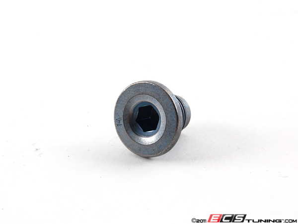

The oil drain plug should look like this: For Gen 2 R56+ MINIs.
#2 http://www.ecstuning.com/Search/SiteSearch/11137585928/
Which takes a 8mm allen or "hex head" bit socket.
And the gasket crush ring
#3 http://www.ecstuning.com/Search/SiteSearch/11137546275/
