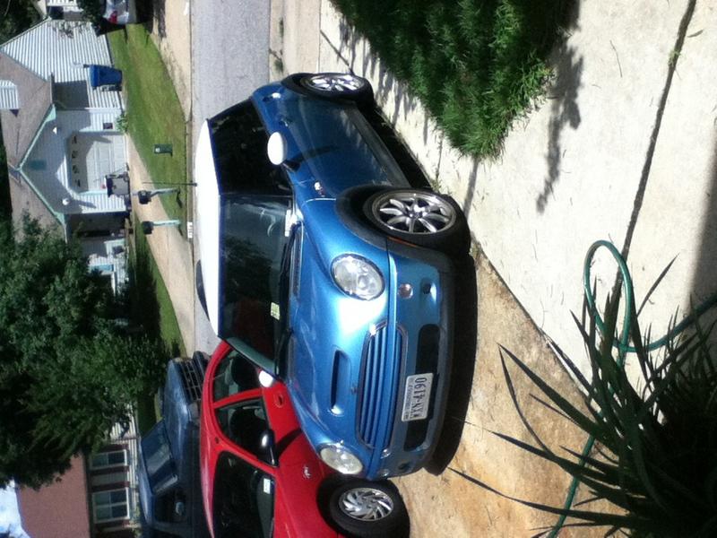

So right after we fixes everything that was wrong with my baby... She started overheating again. The coolant gets eaten up like its candy and I have to refill it like allll the time.. I know the hose is a little dry rotted but that's an easy fix but even after I put the coolant in and everything it still is overheating... When I put the heat on at full blast and all the way on hot the temp meter goes down... I don't know how to fix it.. And I'm doing this by myself.. So as much help as i can get would be awesome...
