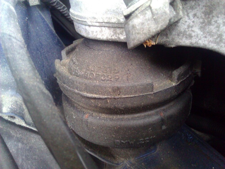

here is what my mount looks like:
It doesn't look bad to me, there is a hairline crack around the top, but no oil leaks.
Old May 9, 2013 | 12:31 PM
Posts: 36,766
Likes: 2,553
Did you have someone rev the engine a bit and look for movement? Looks like it has some wear but it hard to determine movement without seeing it.
Yes you have the older style for the Base Cooper #4 in diagram. Check there.

Old May 9, 2013 | 03:22 PM
MiniSnoop's Avatar
MiniSnoop
Joined: May 2013
Posts: 12
From: Dayton Ohio
I had some one rev it in neutral and in 1st. It had a lot more movement when taking off in 1st than it did in neutral (expected) but i don't know how much is too much. Maybe I can find a video on youtube that i could compare to...
Old May 13, 2013 | 01:16 PM
MiniSnoop's Avatar
MiniSnoop
Joined: May 2013
Posts: 12
From: Dayton Ohio
Ok, I watched my friends 02 Mini cooper engine and his has a lot less movement. So, I think I will look into what it's going to take to replace that (tools wise) and hopefully I find it's something I can do myself.
Thanks again for all the help and input!
