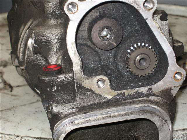

What GOOD gears on a SC PTO look like
Failed, DRY gears...so no WATERPUMP

if the SC gears ran dry, the seals in it are bad,,,
time for a rebuilt SC....
500-1500$
