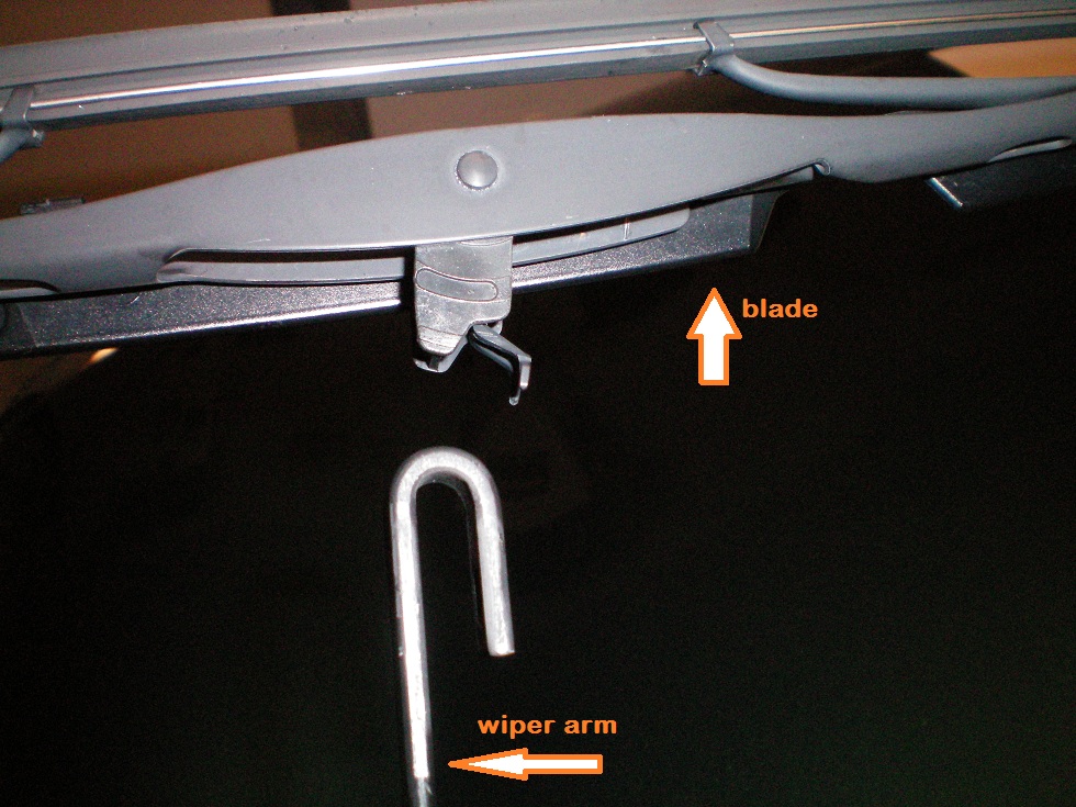

did they change the arms?
this is my 07-S
Old Feb 27, 2013 | 02:06 PM
Posts: 36,768
Likes: 2,553
Yes,
MINI went to a new wiper blade system that is flat aero type.
Which is from 7/2012-
Here is the set for reference:
http://www.ecstuning.com/Search/61610039343/
Fits R55 R56 R57 7/2012 -
They have a flat type insert for all new aero wiper blades.
The R60 Countryman was the first to get the flat type. They have a different part number. No year split. 61610038597
The R58 & R59 have the aero type also and have the 61612239962 part number. No year split there
Currently I only know of OEM Genuine MINI.
Thanks and I hope that helps.
