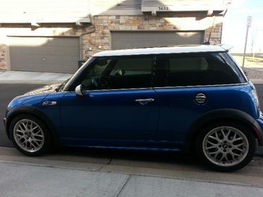

So I was just given a 24ft white stripe kit for my 06 MCS. It says to apply wet, which I already knew. I want to know if I should even try this. I am new to decals and I don't know if it's hard to fit(CUT) it correctly. Or how long they last. Any help will be appreciated, and if you know of a website or if you have step by step pictures; That would be awesome.

Cut yourself a little piece around 1ft if you can spare it and practice, it really isn't that scary. I did my A panels in carbon.. Dry and wet technique. Both came out great but wet was definetly easier to smoothen out any bubbles. I used a heat gun on low setting to help set the vinyl. You'll be surprised at how forgiving the vinyl is just make sure you don't get any dirt on the sticky side.
