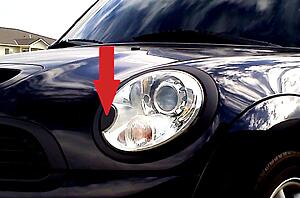

I was driving around on base and noticed this piece was missing:
It must've cracked when I removed it for painting and I didn't realize it. The poor road conditions and the constant shaking probably caused it to fall off on the road somewhere.
I went onto RealOEM to try and find the part, but I wasn't able to find it. I checked lighting, trim, and body work and couldn't find anything that looks like it'd match up. Does anyone know a better way to find and order this piece?
I have an 09 MCS. Thanks in advance! I'll owe someone a beer for sure!

Oh! It's the passenger side that's missing/broken/lonely in the road somewhere. Thanks again!

Should not be too salty to get it through any dealer.

http://new.minimania.com/part/NMX771...2-53-Cooper--S

Ta87,
Try this page on realoem --> http://www.realoem.com/bmw/showparts...85&hg=61&fg=45
Looks like the passenger side cover is part no. 61672752560 (for $6.83). Just Google that part number for some ordering options.

Yeah, you might need number 5 as well. Most of the time it is the jet that breaks off and not the cover. At least this is the way it is on the R53.

Hey thanks fellas! You guys are the shizznit. I just ordered it!
