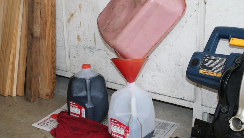

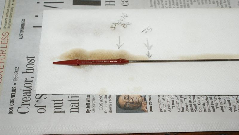

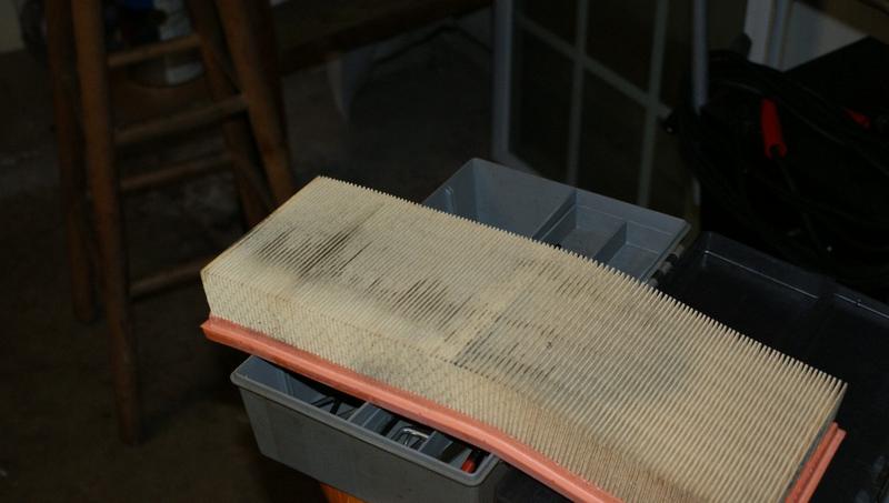

OK, finally remembering I had a extra Oil filter with a washer, i went thru the procedure. Check oil after leveling the car on the driveway, a little oil on the filter, nothing real major that turning it around won't cure.

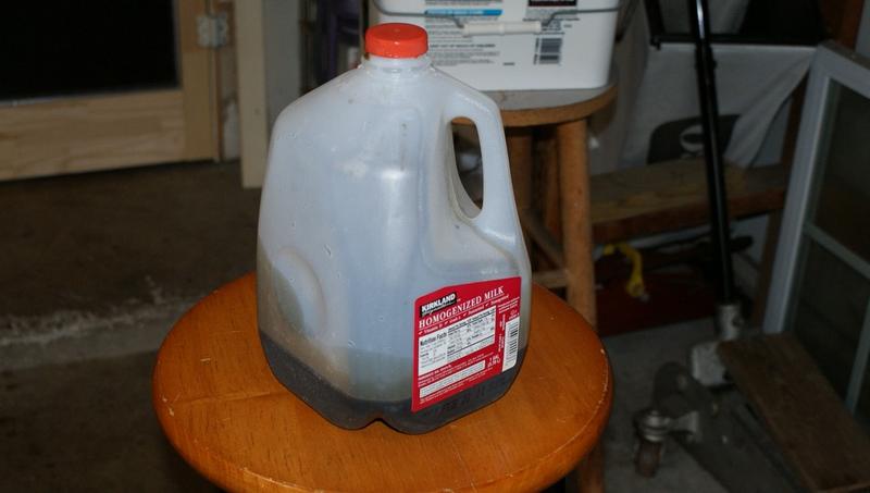

before change and the measure from the 'ol milk jugs
Attached Thumbnails Stealership Oil Change Rant-1.jpg   Stealership Oil Change Rant-3.jpg

now for the addition of my usual, the full gallon and fully warmed up again, and what I did not put back in.
Attached Thumbnails Stealership Oil Change Rant-4.jpg   Stealership Oil Change Rant-5.jpg

Now, after serious contemplation from all of the responses, I was checking the oil cold, as we all do on V-8 and V-6 American engines where the filter is on the bottom of the engine. I fully admit my guilt. Realizing that the french engine has the filter on the TOP, it must be warmed up so the filter can capture the oil, but 4 quarts of oil with this in mind puts the reading dead center in the dipstick. This is without changing the filter, because I am a cheap and retired SOB!
