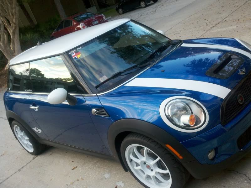

Well the MINI has no tinting other then the strip on the windshield.
As far as ceramic goes it has a nice reflective look to it. So, even if you don't go that dark it makes it a little harder to see in it for those that might want to ****** something from your MINI. Plus depending on where you go most places will lifetime warranty it because it is pretty expensive tint.

A couple of corrections. No car comes stock with 15% (remember the tint percentage number isn't the darkness factor but the light transmission factor, so 15% would mean 85% of the light is blocked ). The number that's generally talked about is 80% for factory in-the-glass tint. A stock Mini certainly has some factory tint, just open the window partially and compare the open portion with the glass portion.
Secondly, tint over tint is multiplicative, not additive. So, 35% tint over 80% factory glass gets you 28% light transmission. (.35 x .80).
