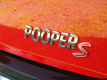

When I changed my Cooper emblem to read Pooper, I just pulled The C off with my fingers, it came off clean, leaving no residue.
