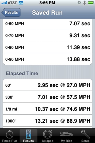

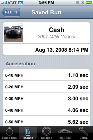

1. The Blackberry won't ever have this because they don't have the Accelerometer.
2. This program is worth 10x what they are charging.
3. My best run so far is below. I didn't get a very good start though.
Settings:
Drivetrain Loss: 0% (program says set at 0% for HP at the wheels)
Weight: 2746lbs
For stability, I put it in my armrest with a small towel to hold it steady. Since then I bought a sheet of that grippy stuff they use in tool boxes and lined it to the armrest. Works great.

Cool beans, thanks for the heads up Scott. Now I have a good reason to steal my wife's ipod touch (it also has an accelerometer, right?).
STLMINI, those results are very believable for a stock MCS with street tires.
I'm not sure what exactly you mean but I should be able to do a lot better if I were in a controlled environment since I have the JCW stage 1.
Settings:
Weight: 2746lbs
Use a higher weight then that...I highly doubt that your 07 JCW weighs only 2746lbs with a full tank and YOU in it.
For me, I plan to use 2860lbs. 05 MCS is said to weigh ~2680, a guy earlier in this thread with the same options as me said his weighed 2653 with 1/4 tank of gas. Gasoline is 6lbs per gallon. So I added 11 gallons or 66lbs to that to get 2719, rounded to 2720, used my weight of 140 so 2860 is the total.
This will give you a HIGHER and more accurate HP since the car is pushing more weight. When I dl this app I'm also going to use 0% whp is more comparable to dynos.

I'll change it to 2888.
2634 + 220 (me) + 66 (gas) - 32 (weight savings from wheels/tires) = 2888

yea, it wont change anything related to timing, but it will make HP more accurate. And as for 66lbs I used that because the other guy measured his R53 with 1/4 tank. The R53 holds 14.5 gal so 1/4 tank would be ~ 3.5-4 left. I have no idea the size of the tank in an R56.
edit* my guess is that 2890lbs will bump your shown hp to 153-155whp still seems awfully low for a new JCW considering non JCW R53s put down those numbers?
