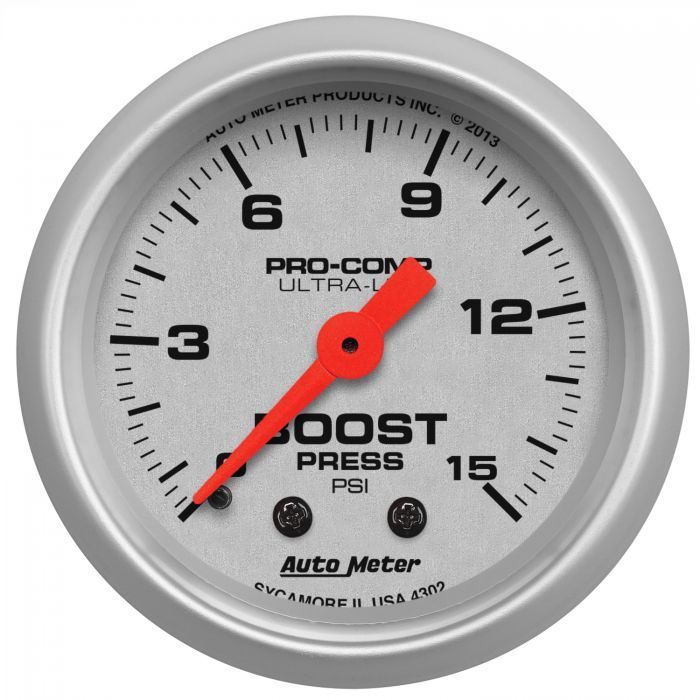

Pro-comp gauges match the stock interior colors extremely well, so I went with them. They seem to be dead on accurate, too.
