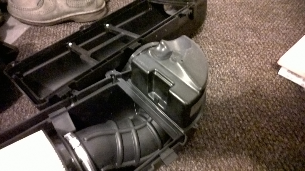

So I bought the N14 airbox and the JCW top airbox, but I ran into fitment issues. The bottom part of the JCW airbox that sticks out (first pic) is hitting the silver thing in the second picture.
Is there anyway to fix it? I've taken off the part that sticks out for now, but the airbox is no longer sealed. :/

Yea, its the newest design on the fuel pump on the N18. it just comes out a bit more because of that line. But I did not think it would come that close, because I have seen it on other N18. First I have seen this tried on an N18 3/2012+ with an extended hose.
What year is your MINI. At worst I would notch that top lid bottom section and them seal it with tape or duct tape. Let me know if you can mod the upper box.
My GP was March 2013 production.
I was going to shave the plastic and duct tape it at first, but i was scared that the tape might melt.
I ended up removing the plastic part that stuck out and replaced it with a sheet of aluminium that i cut and drilled.
The airbox is mostly sealed now. There is only a small gap since my aluminium sheet just wasnt quite big enough. I will see if i can find a bigger piece of aluminium later and have it properly sealed.
