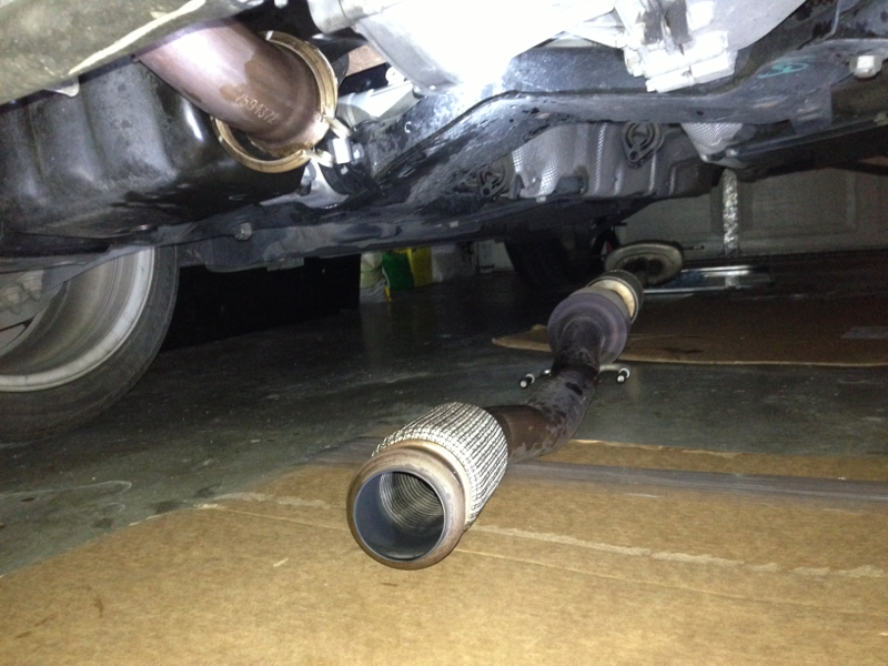

Alright guys, I need more tips to get an access to the shifter cover underneath the car. Do I really need to drop the exhaust? I don't want to deal with the V band from the down pipe. How do you remove the heat shield?
Old Apr 7, 2013 | 12:10 PM
  #39
KilmerPT's Avatar
KilmerPT
Joined: Nov 2012
Posts: 645

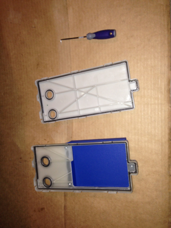

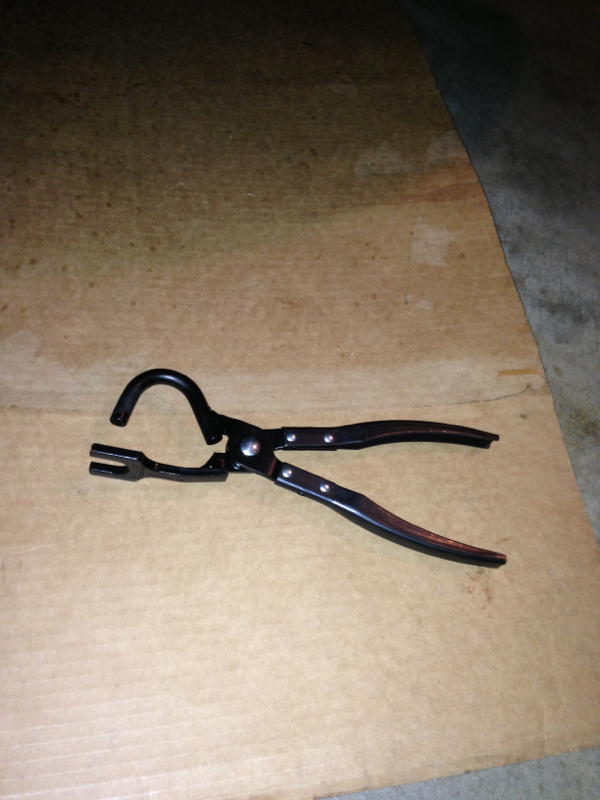

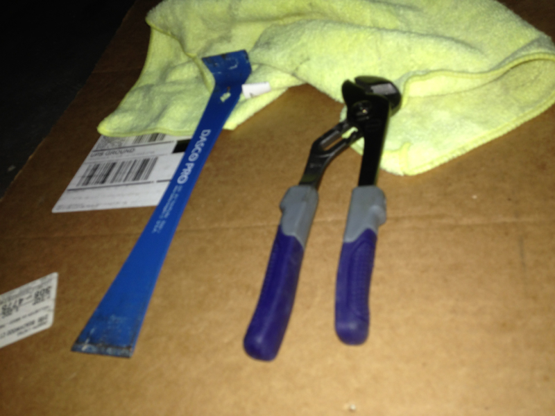

The V band clamp on my MCS took a 16mm deep socket to remove the nut. Then I used some PB Blaster to loosen it and waited 10 minutes and the bolt slid right off with a little tap. Then I used a pair of needle nose pliers to pry open the V band and slid it towards the DP. After that a pair of exhaust removal pliers will make it super easy to detach the exhaust from the rubber hangers. I went front to back and used an extra jack stand to help prop up the muffler/tips up while I took off the last rubber hanger. The heatshield needs a standard 10mm socket. A 90-degree poker will also help remove the cover. And to undo the ball joint, I used a small pair of channel locks and a small pry bar. Good luck!
