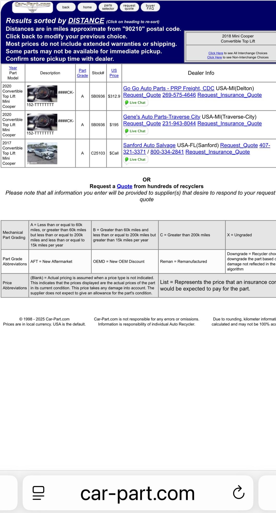

You know, you can always try car part.com
www.car-part.com
There is always something new there and you might get lucky. Great source for hard to find parts.
the only downside idle that you need to be handy or the shop you use needs to be good with client supplied parts.
wishing you success on your search
