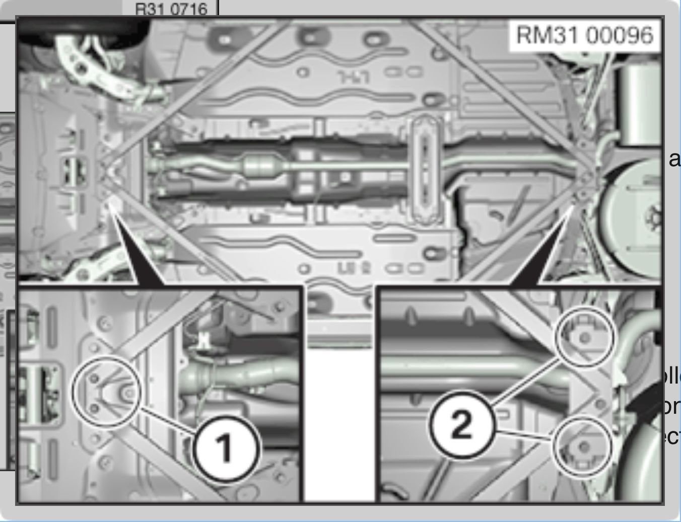

Hello- Could someone post or send me a picture of where a floor jack would be positioned at either the front or rear to allow both wheels off the ground. I want to jack up both wheels at the same time so I can position jacks under the jacking points under the car. thank you so much!!!!

Thank you for the reply and pics. I can put the rears on ramps and jack the front up and put jack stands under at the jacking points. I do appreciate it!!!

The old boy is gone now but here's a leftover from his page: "How a 2 X 4 lifts a MINI". Cut it to the length between the two jack pads then run it while on the jack under and between the jack pads
