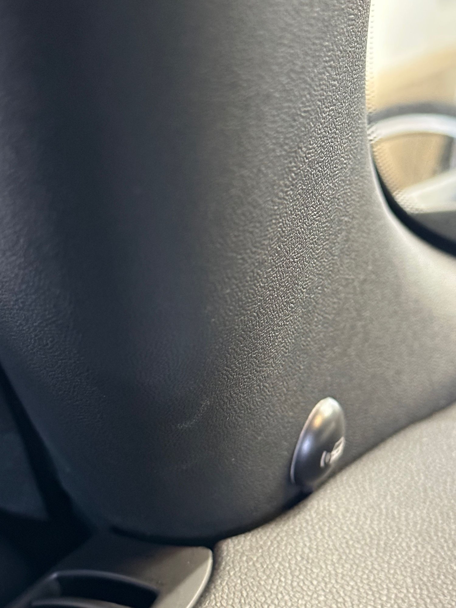

Update: Our MINI now has Advent 3.0 blind spot detection on both sides, installed today by a pro shop. It worked exactly as expected and hoped on the way home, with a red LED flashing whenever anyone came up behind me in either highway lane next to ours. The LEDs are at the bottom of each side post of the front windshield, rather than inside the outside rearview mirrors.

Closeup of warning LED button
Mounting location of warning LED button

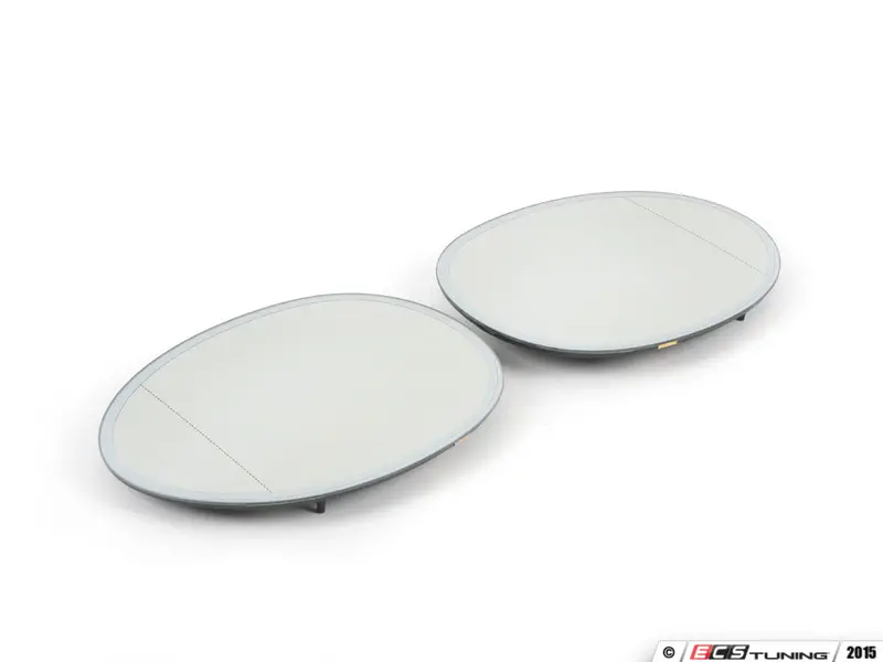

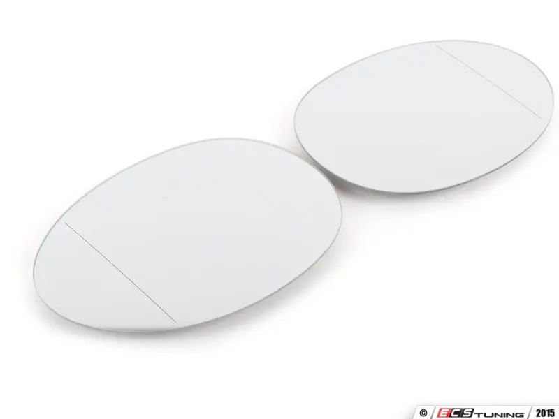

Nice, i have the blind spot euro mirrors on my R58 and R52 Convertible and they help a bunch. We are one of the few places that can get them.
F55 F56 F57 and F60 is what the ones below fit.
https://www.northamericanmotoring.co...nvertible.html

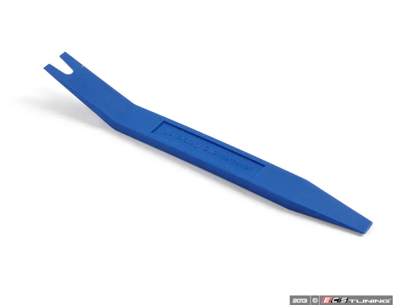

For the blind spot mirrors, turn mirror al the way out. Use a trim tool and put pressure and pop out. You will have two wire to clip out and then clip back in. If you have auto dim you will have 4 wires.
Snaps back in, press and snap the center. That's the tool I use.
https://www.ecstuning.com/b-schwaben...ieces/phr-05s/
