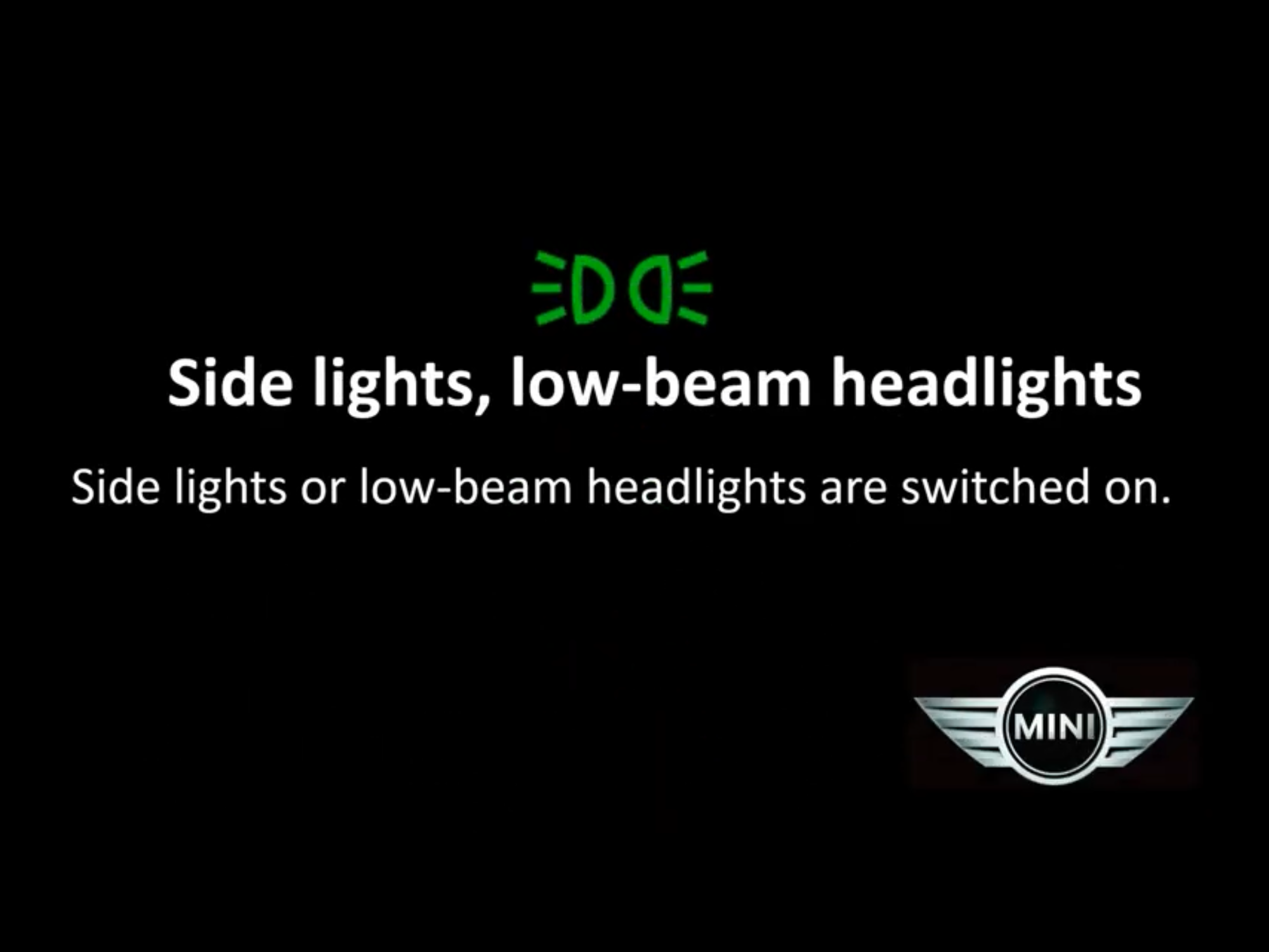

Thank you for your reply, but I am still uncertain that my car is okay. When your headlight switch is turned all of the way to the left - Automatic Headlight - do you see the corresponding lit icon show up on your dashboard. During daytime/after dark? Also, if your headlight switch is turned all of the way to the right - Low Beams - does the corresponding lit icon show on your dashboard? Only one light shows up on my dashboard - the low beam icon:
This is the only light that shows on my dash, not the automatic or the low beam.

The symbol you’re taking about, the one with the ‘A’ on it, is for the automatic highbeams. You have to activate them with the button on the end of the left steering wheel stalk. The indicator for the automatic exterior lights is the green symbol you’ve posted.
