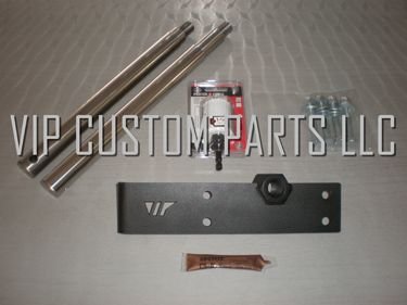

Wait!! I just remembered another option!
http://www.vipcustomparts.com/F56%20parts%20page.htm
Their bike rack retrofit kit is $250.

As a result of asking the seller, the f57 model does not fit
