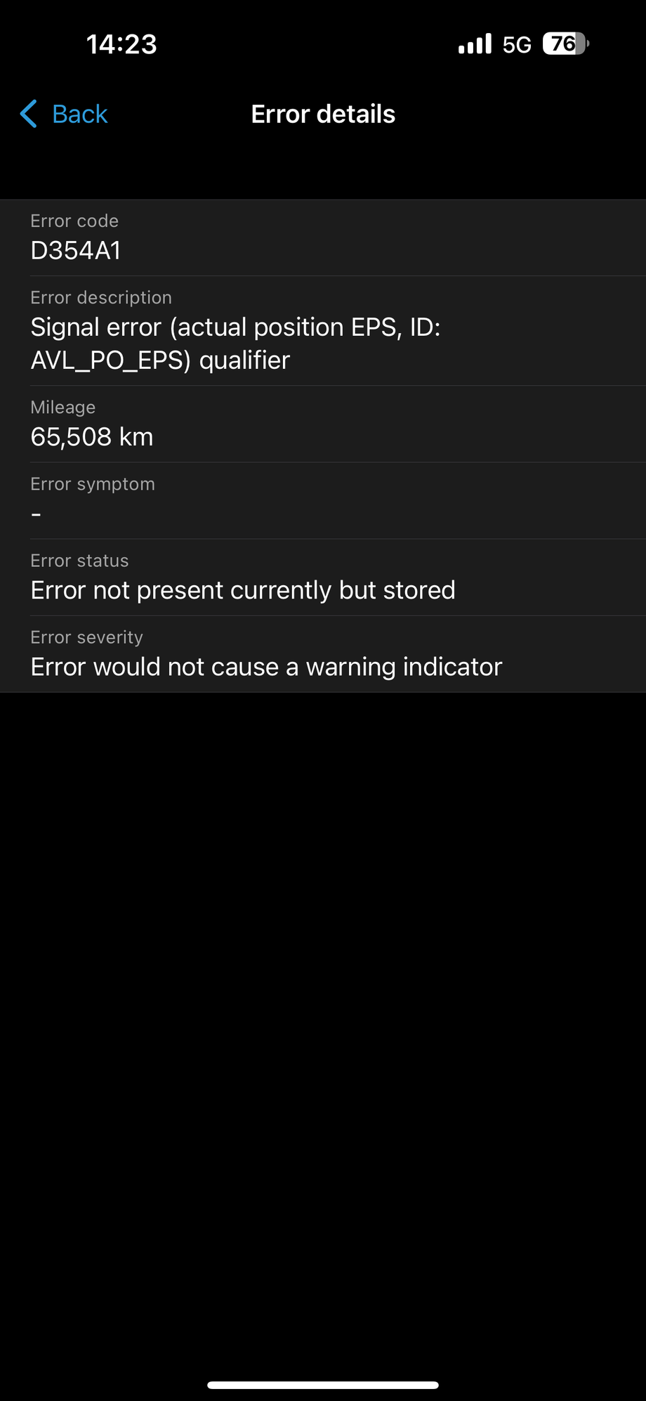

thank you so much for all the help last time. This time is kinda tricky. I just changed my battery 2 weeks ago after almost 9 years. I thought I was lucky but yesterday my car threw a warning “Drivetrain malfunction” and I have my reader to get me two codes “P13B8” and “P13AE”. After some research, people are saying that they are codes for “knock” sensor.

thank you! I actually have that and in fact there are 5 codes….
i am not sure if it’s because i replaced the battery about 3 weeks ago or it’s the aftermath of a highway pothole (it happened after that).

thank you! I just did that. And my windshield fluid sensor is bad too. I wonder if they are all related to the shock when I ran pass the huge pole hole. Seems like everything doesn’t work right after that. Thank you!
