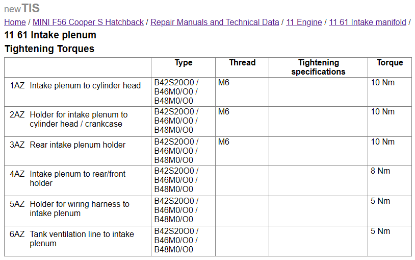

Sure would be awesome to have a master list of torque values for the F56 as it seems impossible to find online anywhere.
Anyhow, got around to replacing my OFH and now need to reinstall the intake manifold (yes, with new OEM gaskets) and I cant find torque specs or bolt tightening order specs anywhere. Anybody know what they are?

Since it uses those rubber intake gasket seals, it doesn't need much to seal.
Here is the factory torque table: 10Nm is about 7 ft-lbs

You're awesome. Thank you very much!!
