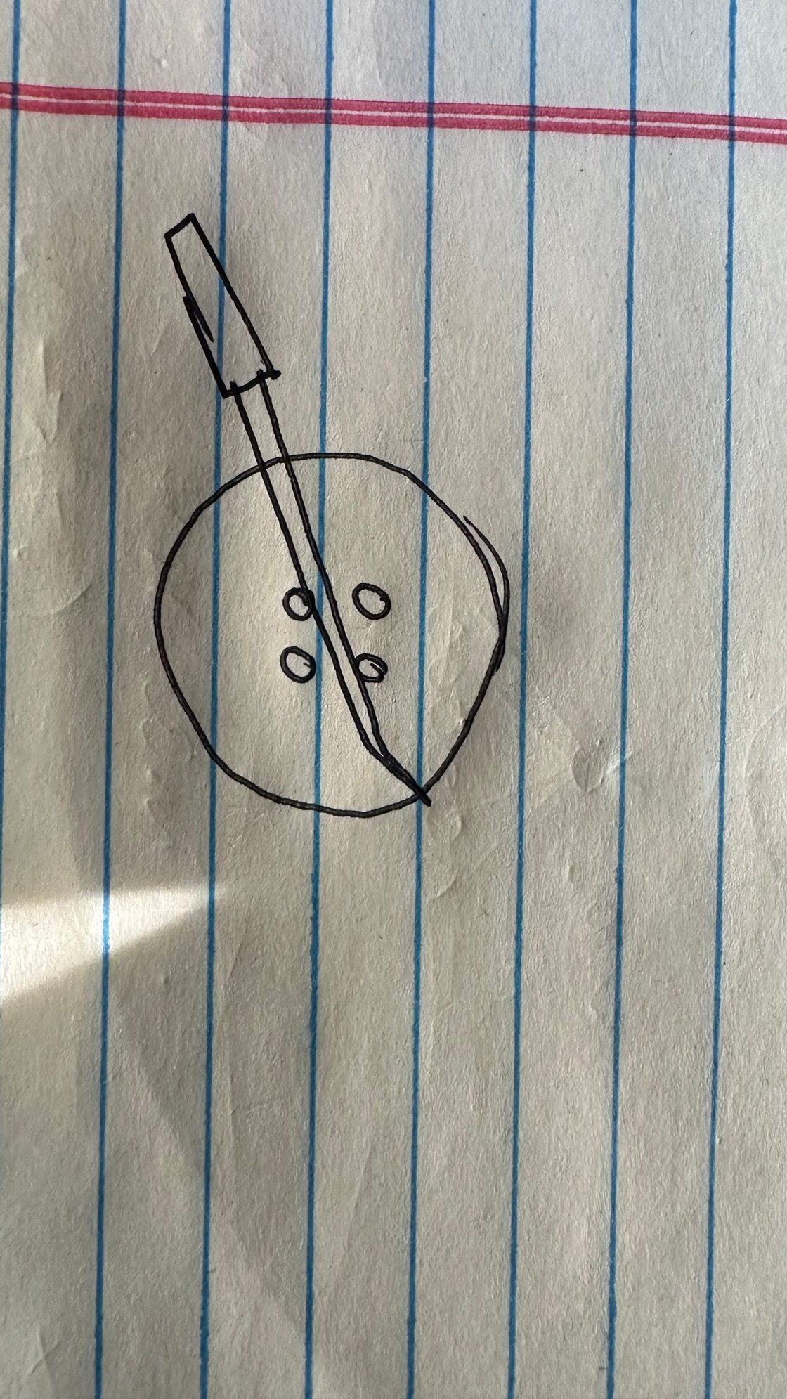

In order to do this install and "lock up the crank" all you need to do is snug the crank bolts before you attempt to torque them, take a breaker bar or something meant to leverage (ideally a square shaft vs a round one) and lay the bar across a couple of the bolt heads while you tighten one, then move to the next opposite bolt and reposition the bar. You will need a second person to position and hold the bar with resistance while you torque the bolts. For the record, the torque spec is very low (if I recall its in the 20s) so this will not be difficult at all. See my hand drawn diagram below.
You had me until "second person," I didn't have a spare one of those lol
Seriously though -- thank you! I wish I had thought of this approach! Yes, the torque spec is very low -- 28Nm if memory serves. However, TIS also specifies to turn another 180 degrees (new bolts, of course) once torque-down to that spec is met.
With my makeshift locking attempt (you don't want to know), I ended up only able to turn 90 degrees. Figured that was fine... until about 3300 miles later, when I found a new oil leak that I'm pretty sure is the front crank seal. Oops.
But with this guidance from you, now I think I can handle the leak and the torque-down properly. Thank you so much!
