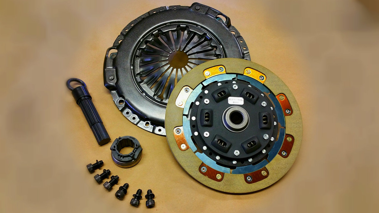

Old Sep 21, 2023 | 01:13 PM
Tigger2011's Avatar
Tigger2011
Alliance Member
Joined: Jul 2013
Posts: 1,474
Likes: 248
From: Sunrise, FL
Hi Johnnys2quick.
In the thread njrameka linked the original poster switched to a TTV Racing ceramic and had no more issues. Gotta say I've also been impressed by this clutch. it's easy to drive on the street and will take some serious abuse. They also make a full faced organic version.
Old Sep 21, 2023 | 02:48 PM
njaremka's Avatar
njaremka
Alliance Member
Community Builder
Community Influencer
Joined: Jul 2016
Posts: 7,582
Likes: 2,517
From: WNY
Originally Posted by Tigger2011
Hi Johnnys2quick.
That clutch looks brutal!
Old Sep 21, 2023 | 07:34 PM
Tigger2011's Avatar
Tigger2011
Alliance Member
Joined: Jul 2013
Posts: 1,474
Likes: 248
From: Sunrise, FL
Yeah these guys build them strong. I'm still amazed how easy it is to drive. The flywheel is machined from forged chrome moly steel and the rest of it seems to be built with the same design philosophy. I guess they figure a clutch isn't of much use if its broke lol. The one above on my F56 is a 230mm ceramic unit rated to handle 480 ft/lbs of torque. Another option is a full faced organic clutch that's rated to handle 350 ft/lbs of torque and should be even more street friendly.
You also have a couple of options for the flywheel. There's the one above which is a good all around weight that's easy to feather that I drive daily. That entire clutch assembly for the F56 weighs in at about 25 lbs. They also have another flywheel that's even lighter but is really more for racing applications. If anyone is interested in seeing a twin for the F56 I'll try and remember to dig it out and post some pics tomorrow.
