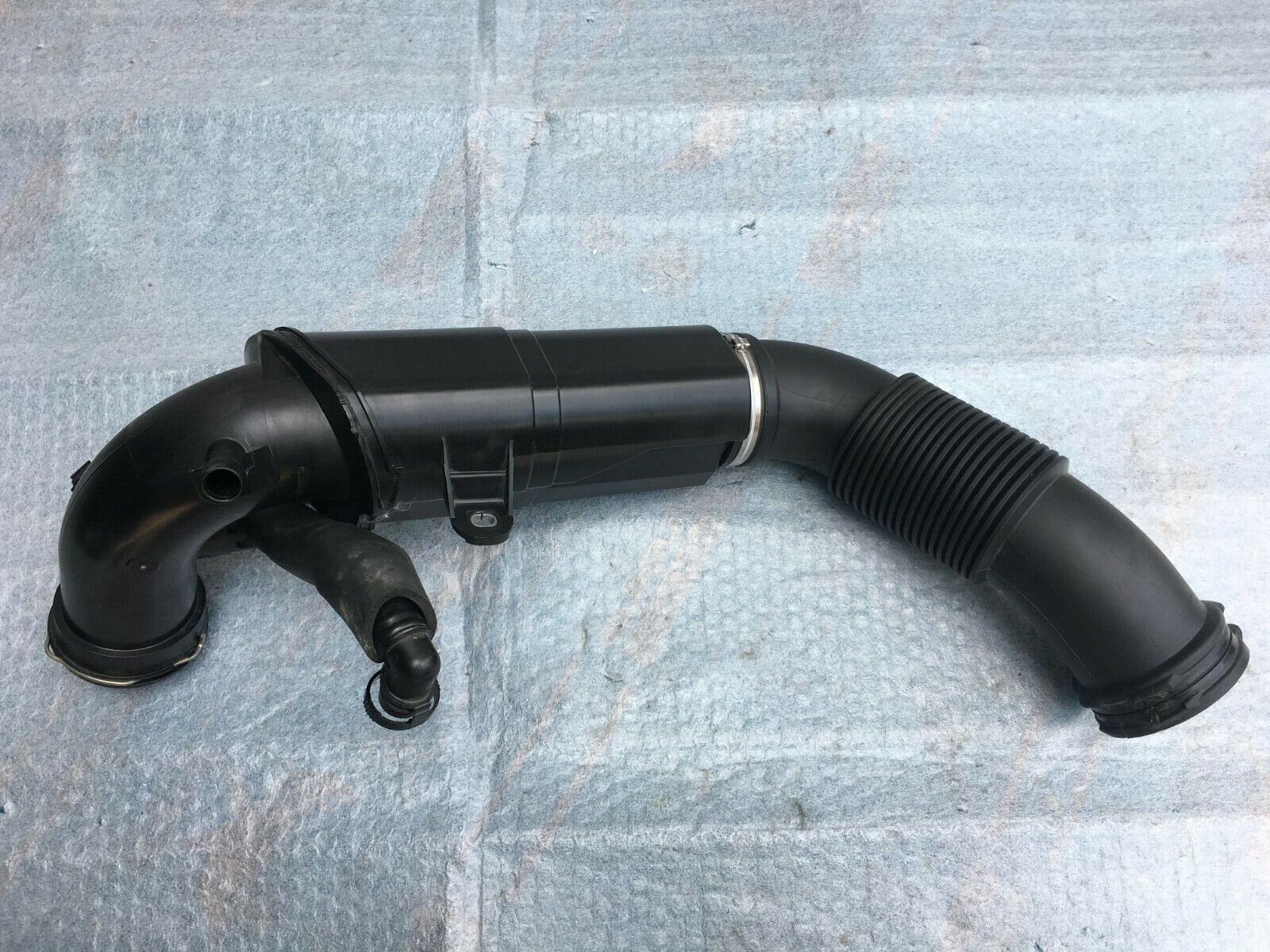

4. There appears to be an additional mass air flow sensor up top by the air box. Does anyone have any idea why this is the case? Curiosity got the best of me and I moved the wire over to this other sensor and the car seemed to run rougher overall.

Have no idea what that secondary input is on your intake. Is it always open to air? could cause car to run like crap since airflow/debris getting into engine after the MAF.

The MAF sensor with the green goo should not be there. Looks like they cut a hole to install one where there should nt be one.

Yeah that was my first thought, why is there a second MAF sensor mounted in the intake tube with nothing connected to it?

yes, should not have second maf?

Yeah that second MAF looks to me to be an "aftermarket enhancement" where "aftermarket" was someone thinking they were going to move the MAF and "enhancement" was the same someone thinking it was a way to accomplish... "something."

That MAF situation would have me very concerned.
