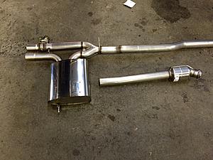

The JCW Pro exhaust still has the second cat, but no resonator.
