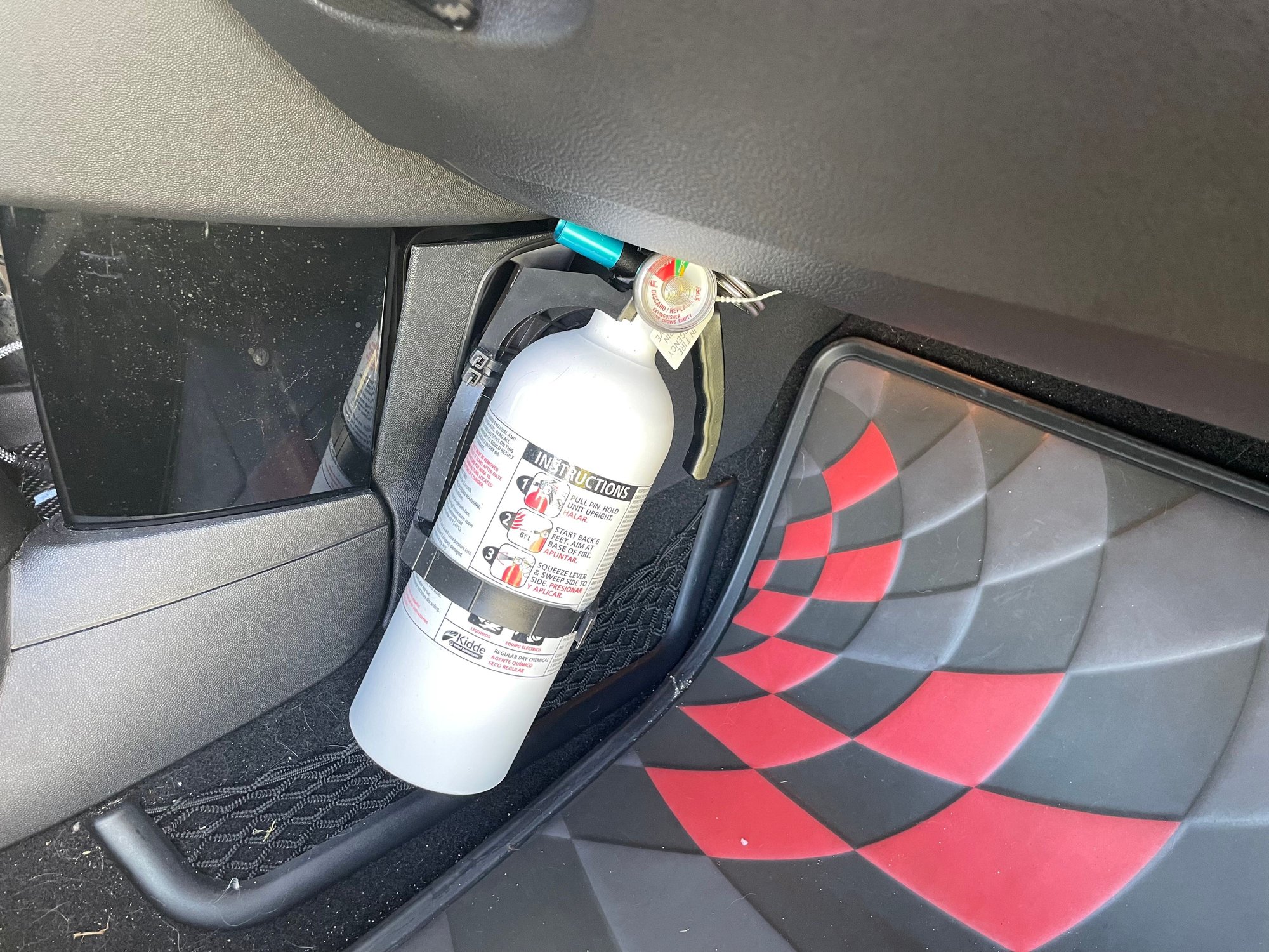

I wanted a fire extinguisher in my 2015 F56. I didn’t want to spend $100 plus on a mount, so I took the included bracket and zip tied it to the lower console of my car. Been there for over two years with no issues. Not the prettiest, but it’s effective.
