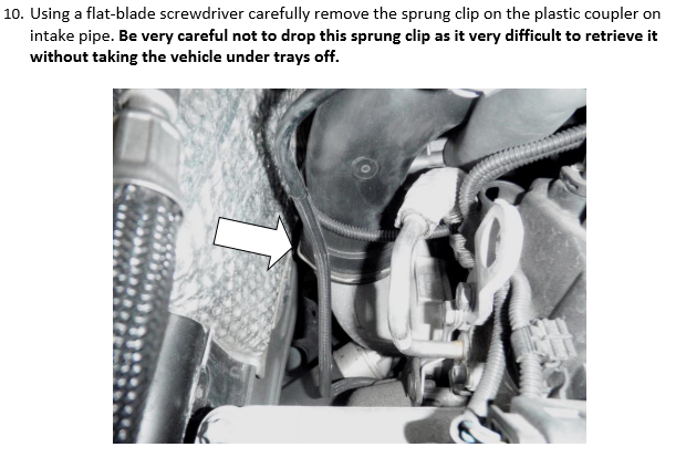

The is the grey part of the electrical connector. You have to slide it out a bit so you can then squeeze it to release the clip. They are pretty hard to actually pry off. I just used a flat head screw driver from the side of the clip to pop it out a bit then a needle nose pliers to squeeze it and release it from the connector.
Attached is a photo of what it looks like after it is pulled out.
Sorry for not being more specific. It's the clip that's mentioned in step 10 of the install guide.

So that little arrow points right at the clip. It is a little wire connector. There is a little bubble at the end of that arrow that you can fit a flat head in. Once you get the other pieces out of the way you can easily put your hand back there and catch it when you pry it off. That is what I did
I was a little freaked out about that part too but it was really easy. I did it 2x in -2 degrees
Sweet! Parts shipped today so it's either I do this Monday or wait for the next weekend. I'll post up pics when I'm done.
