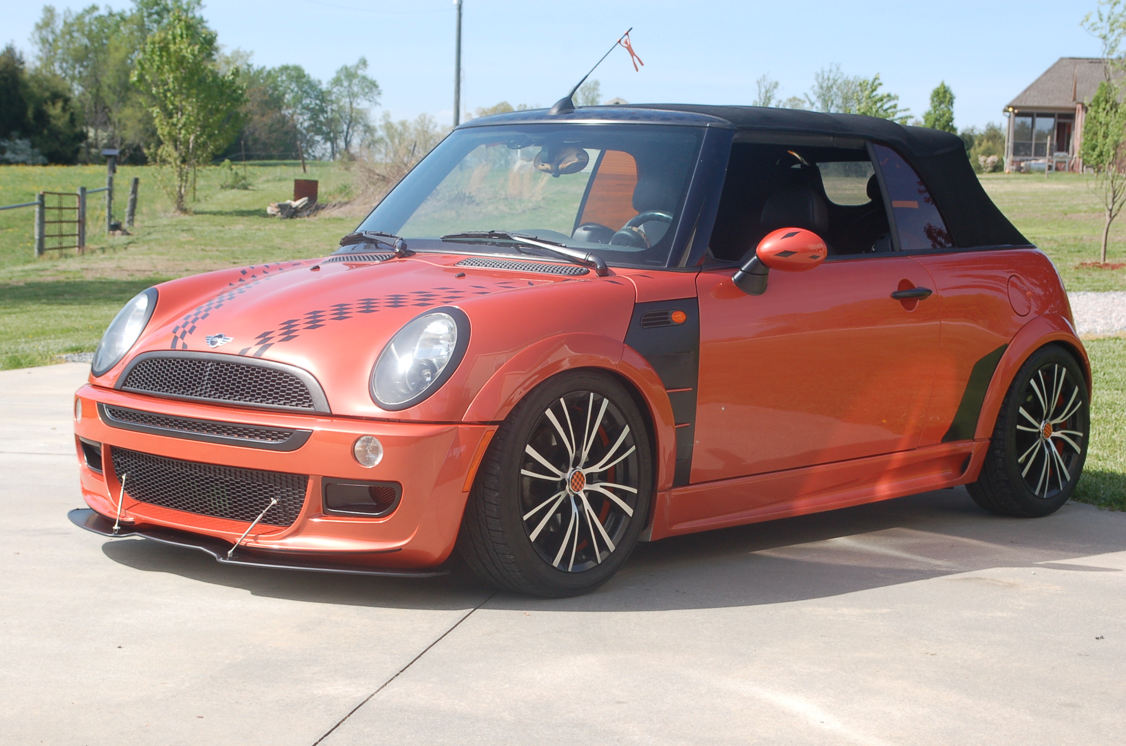

Joey Modded Headlights- $8 can of Plasti-dip
Stripes/graphics- pretty cheap to unlimited amount
DIY Front Splitter- virtually free with access to CNC machine
Cat-back exhaust- not toooo pricey if you install yourself ( but can be )
Vented A-Panels- can get alittle pricey with paint etc. but looks cool
Rear Sway Bar- best bang for the buck performance wise- $225 or so if you do install
The list can go on. Pic of some of these are in my Gallery on here..

I'd love to see pics of your car

Here is a few. DIY Brake ducts vents as well.

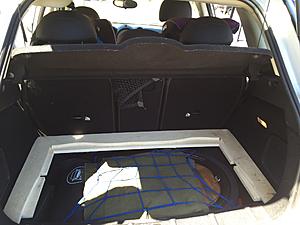

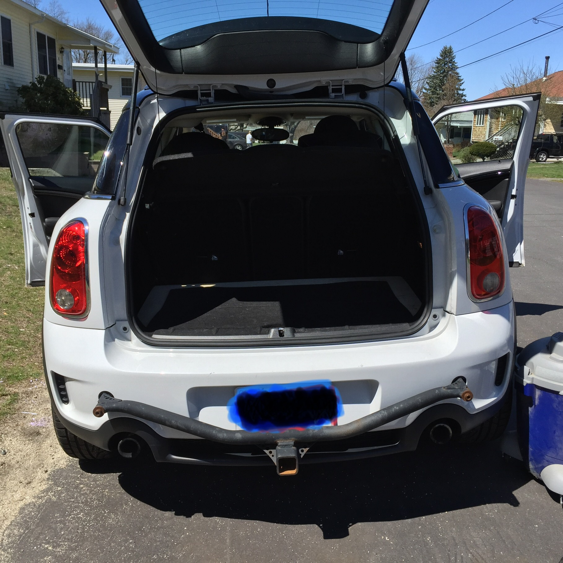

R60 Countryman flat floor mod
Hi! Do you have any pictures of this? Not getting the flat load floor on my 2013 Countryman is my only regret. It sounds like my husband might be able to do the same thing you did.
Originally Posted by bratling
My wife's R60 Countryman came without flat load floor. I bought a used FLF floor panel, got a sheet of ¾" maple ply, cut to fit, including notches for the centering pins and support for the panel. It rests upon existing trim panels in the car, but it would be trivial to add standoff legs if needed.
We left the wood unfinished, but I recently bought speaker fabric to cover a subwoofer I built for my car, and I'm thinking of finding some time to cover the wood and make it blend in.
It was a good use of a couple hours of time to set up.

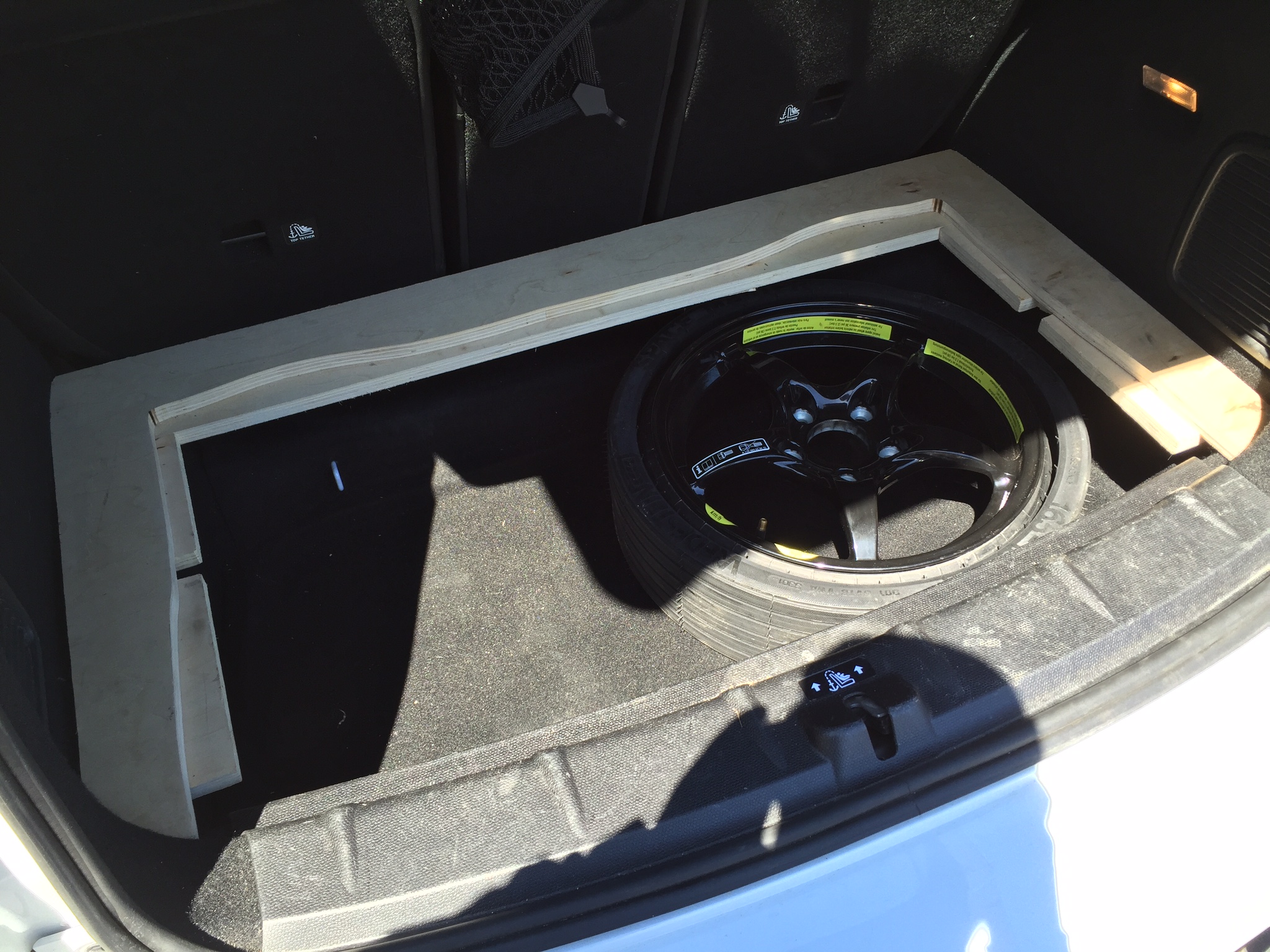

Sure! Just went digging through my photos. I’ve attached a few to this post. But I’d say this is the most useful for those wishing to pursue this:

Note that the outside edges are NOT entirely square. I made a cardboard mock-up to get the angles right before I cut any plywood.

What is the source for the spare ... looking for one before MTTS

Strange looking tire on that spare.

That is a blow up spare from an early 2000s small Mercedes (5x112) It is 15 inch so if you have anything other than a Cooper you will have to mount the spare on the rear. Also the spare is made for 12mm ball seat lug bolt so you will have to drill out the bolt holes to 9/16s or so. Once this is done the spare will be functional for 50 miles at 50 mph.

The standard 14mm bolt will work for the revised blot holes.

what Tio Barry said it is FAR from an “inexpensive mod” but I feel better with this set up for my spouse. Here is some more detailed info on it:
