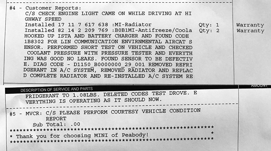

Originally Posted by shorenetworks
In other news got my first check engine light this morning U019D no luck finding any info online going in next Tuesday.
I'm following up on this – in April my check engine light came on, and the OBD-II code was U019D. Automatic's app guessed incorrectly at the meaning of the diagnosis, which turned out to have nothing much to do with "Direct Ozone Reduction Catalyst Temperature Sensor".
I took it to the dealer. Tech hooked it up to the MINI/BMW computer and pulled this code: 1B8302 FOR LIN COMMUNICATION ENVIRONMENTAL AIRCAT SENSOR. That indicated failure of a sensor that is part of the radiator.
Replacing this sensor required replacing … wait for it … the entire radiator.
Attached Thumbnails F56 review and issues-mini-check-engine-code-u109d-diagnosis-and-warranty-fix.jpg

I've had the code come up two times so I'm on my 3rd radiator.
so far since the last time in the shop I have put on 1200 miles without another code but still leaking oil.
