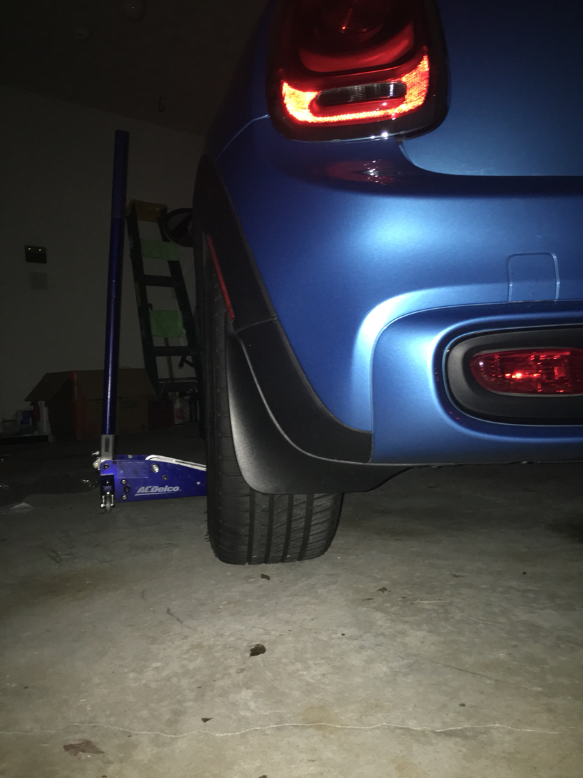

Random note, but buying the oem rear mud flaps gives the rear of the car a much more standard look. I have a bad phone photo of what I mean.
