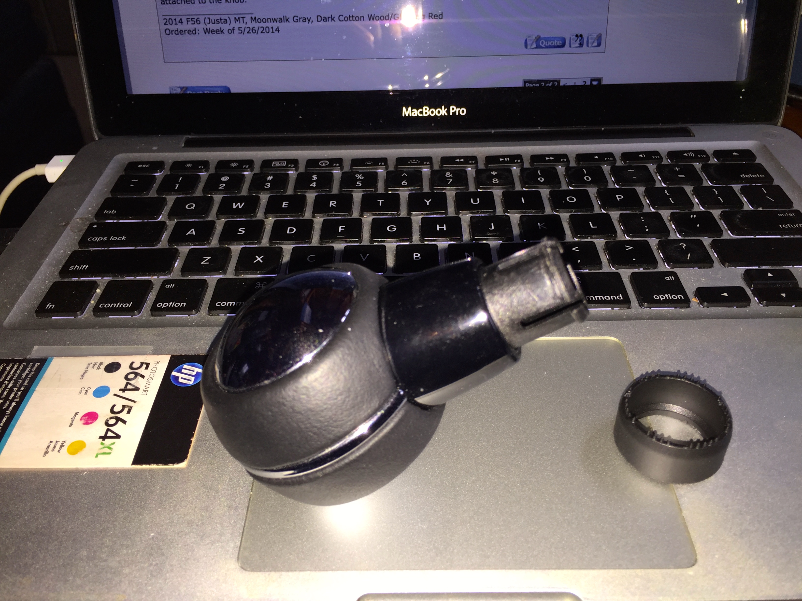

Pop the ring loose from the console. Don't forget to unplug the connector before doing anything else. Lift the ring and boot over the ****, kinda like taking a t-shirt off. On the bottom of the **** is a collar that you can remove to release the boot from the ****. Push the boot down away from the **** and you can continue destroying the stock **** without damaging the shift boot. I'm with Doug W., use a hack saw or a big bolt cutter to take off the top part of the shifter. Then you can install your new Cravenspeed short shifter and the **** of your choice. Or, if you want to retain a stock shifter, I'll send you my pristine OEM shifter for a significant discount.
Is there a trick to doing that? There's no obvious way to remove the collar. It seems to be really intimately attached to the ****.

It'll pop right off with a wide tip standard screwdriver or a trim removal tool. I used my Leatherman. Just be careful not to tear the boot. Piece of cake.
You mean just shimmy it down the shaft, off the **** with a "blade" (I have trim tools)? I didn't realize that was possible.
Thanks for the pic. It's quite helpful!

The collar will slide slide down the shaft allowing you to slide the boot down the shaft also. The boot and ring can't be removed completely until you get rid of the ****, one way or another.

Thanks everyone SO MUCH for your help, especially the pictures, which helped immensely.
So, what did they glue? The Boot retaining ring was locked tight to the stick, and NOTHING would break the seal. Once I knew that therein lay the culprit, I finally have the **** off, and all is well. Had I known sooner, I could definitely have saved some wasted muscle and sweat in futility.
