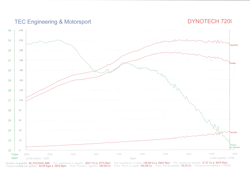

Originally Posted by TheBigNewt
No in his mind.
Terry can explain in more details.
"With the B48 connecting to the TMAP allows you to control boost pressure, while connecting to the MAP gives the additional functions of timing and AFR control. In addition our Stage1 can accept our FlexFuel add on connector for E85 mixture mapping. Really neat stuff."
I did it for use E40 (40% ethanol and 60% gasoline). modify the parameters of pressure and flex fuel by software BMS JB4.
Last Dyno:
Pressure +6.5psi
Open loop 51
E40
Downnpipe cutout
Pressure +zero
Open loop 51
E40
Downnpipe cutout
