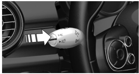

This is how you're supposed to be able to get the speedo:
https://www.northamericanmotoring.co...al-speedo.html
Well, I had to order the essentials package to get the sports suspension, and then deleted the sunroof. I didn't want any of it. That would make me very angry. The car I test drove had a sunroof and the digital speedo.
p.79 of the manual also says what MasterYoda mentioned, but it is unclear from the manual what it does.
Adjusting the info display
You can select what information from the onboard computer is to be displayed on the info display of the instrument cluster.
1. "Settings"
2."Instr. cluster display"
3.Select the desired displays.

Here is the latest. The on-board computer is an option for the LOADED PACKAGE. Without this you will not be able to have the KM/hr displayed.
In my case, I didn't buy the Loaded Package (not made aware of this, was standard on my 2008 & 2013), therefore I will not be able to have the digital KM/hr displayed. Anyone else having this issue or am I sold BS ?

When you press that button, what does the display cycle through?
This photo that you were very nice to provide is the "bc" button and in my case ONLY gives me the Engine Temp on the dash display....NOTHING ELSE...My 2013 Coupe and prior 2008 Classic when you used the "bc" button as your illustration, I could go thru all the menus to configure the dash info, and that included my digital speed....I am in SHOCK.
