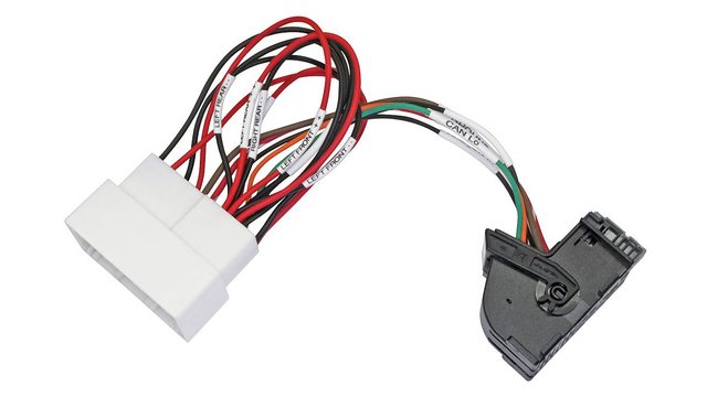

Old thread, I know, sorry (!), but for anyone coming across this we also have an ASD defeat harness: https://integralaudio.com/active-sou...-and-mini.html. Ours has nice little labels as well, for anyone who wanted to hack it for a signal wiring harness and pull the flat signal coming from the HU.

Don't recall reading of people having issues with coding out the ASD. The harnesses should work well, either from Integral Audio or Technicpnp, both do the same thing.

Yeah, agreed. Not sure where they're getting that info from, ASD module only receives. Even so, our harness does not disable or alter the ASD module. If you look at that picture above you'll see that the power and CAN signals still go to the ASD module, and it remains functional and on the CAN bus. We do that (same as we do with OEM amps and other components with our Soundstage™ and other harnesses) so that there is no change to any vehicle components. If you were to go to a dealership for service and they did a software upgrade the ASD module will show as present and fully functional, and any software upgrade to it will complete successfully.
