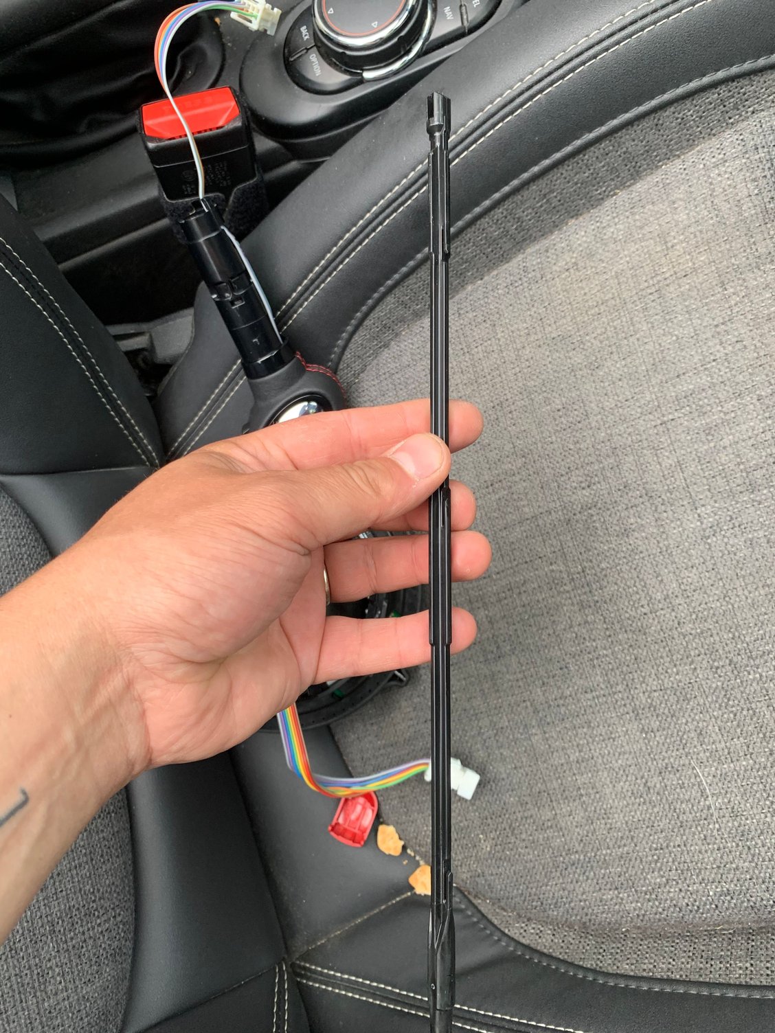

Guys I need help!! JCW Gearknob that came to me was without central plastic shaft ( for button ) I thought it will be simple and removed my plastic ( easily pulled) shaft, but now I can't fit it either in new or in old ****. Nothing seems to be broken, just can't figure out how to make button work and more the shaft. Currently I'm riding without shaft at all. All works, simply without blocking button, but I want it to work as it has to be

Hi, everyone. I need your help!!
I bought JCW ****, but it came without plastic stick that goes into shaft. I removed my old one ( simply pulled from inside the **** and it came). But when I'm trying to install it I cannot fit it properly, button to work and to move this plastic stick. There has to be some trick?
Can someone give some advise?

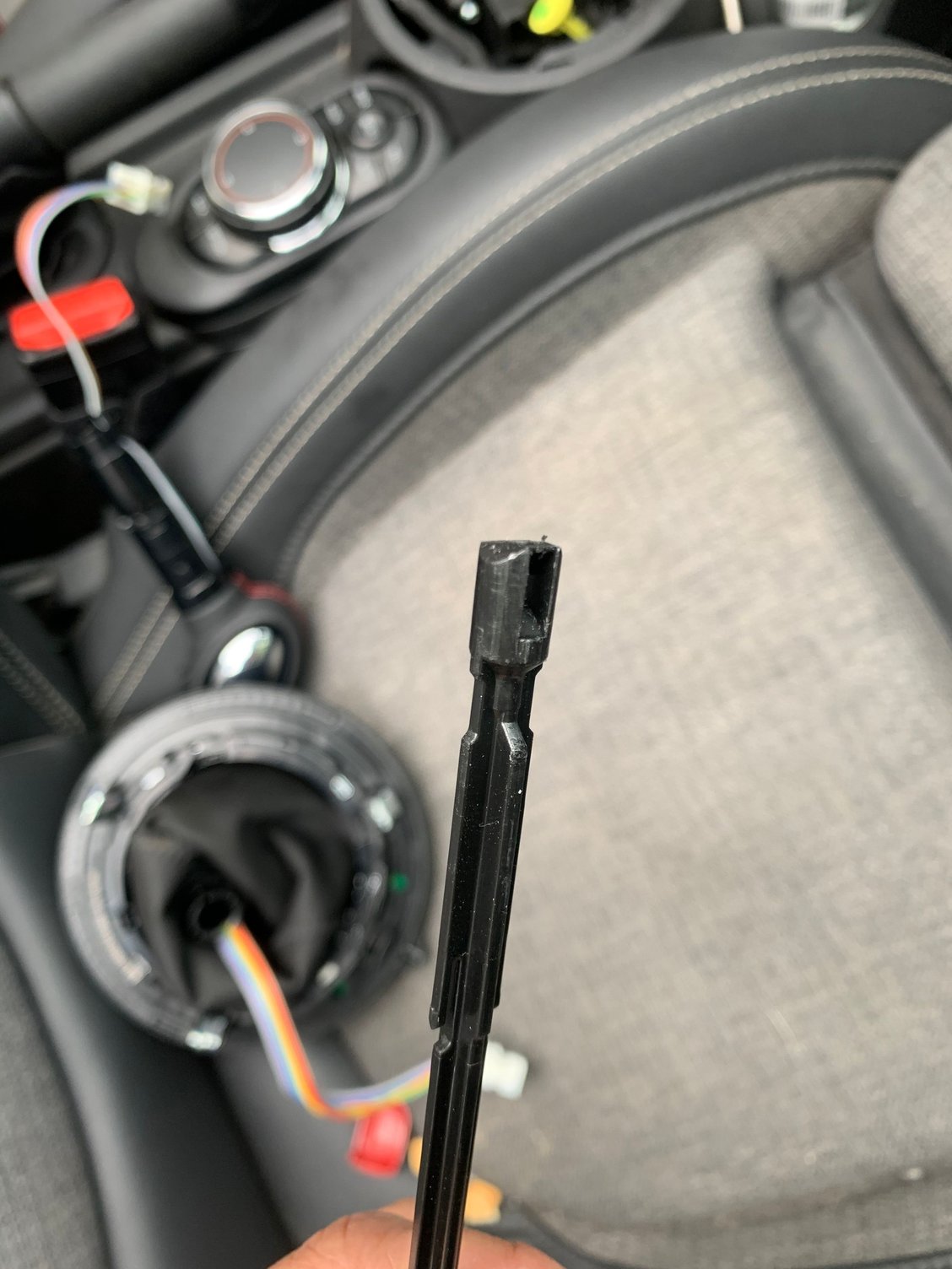

This end of the stick that I cannot fit properly
Whole shaft stick

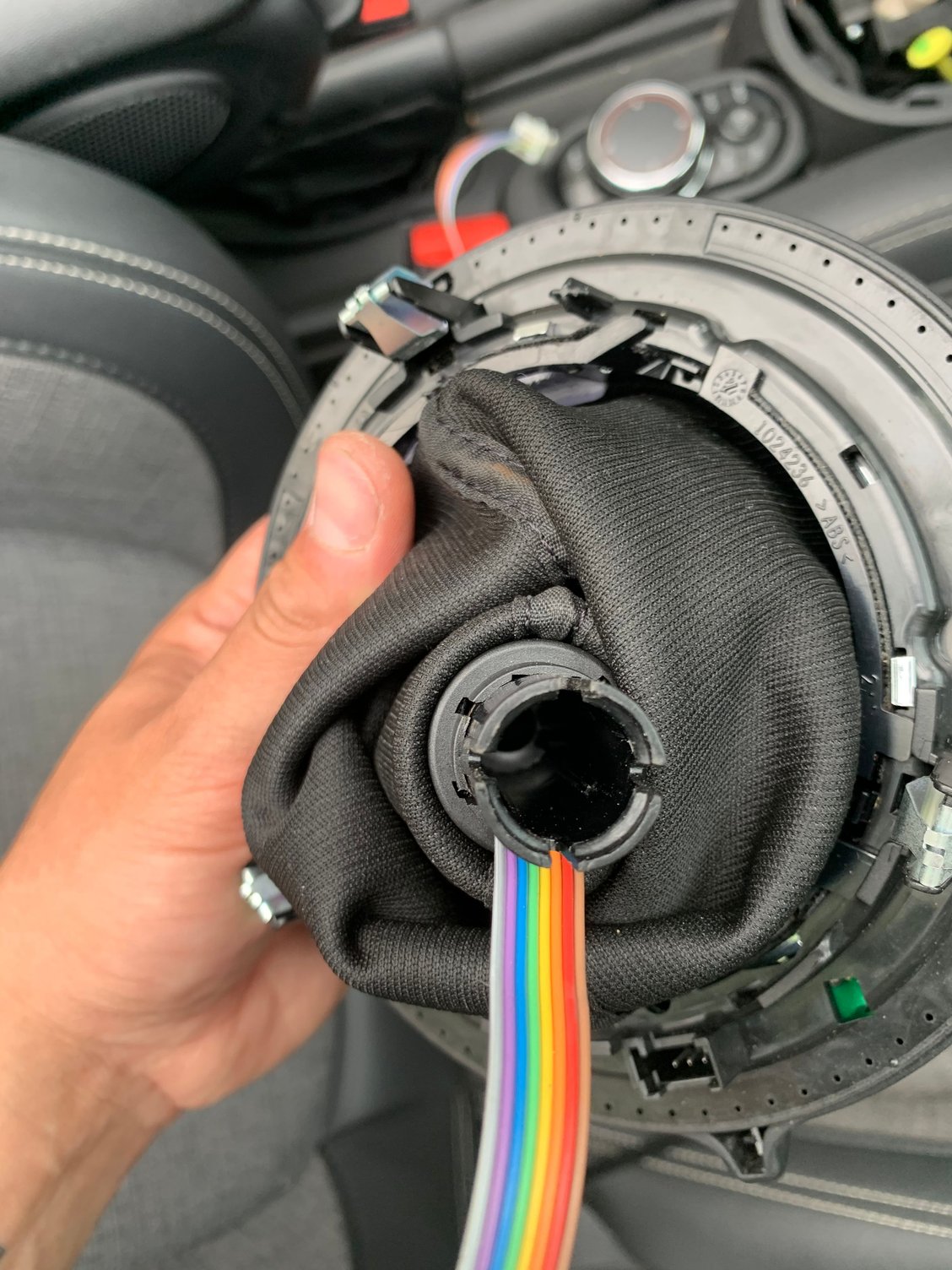

Fixed!!
the problem is in metal finger that holds plastic stick that goes into the shaft. When you remove plastic stick metal finger goes in red position.
the hardest part is that when you connect the plastic stick you need somehow to push metal finger in blue position. Than it will hold plastic stick and move it when you press the button
In normal position you cant see that metal piston ( marked green)
