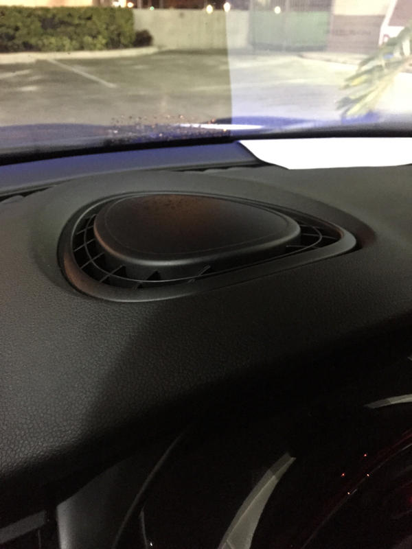

Originally Posted by MidnightF56
Are you talking about the huge air vent on top of the dash? There's no dash speaker AFAIK. Are you sure it's the vent that's rattling? Mine had a similar noise, but it was actually the rear view mirror windshield mount/base. Try putting your hand on it while you're driving and see if the rattling stops.
There's certainly a speaker on my dashboard.
I can suppress the rattle by firmly pressing on the grille with my hand.
I'm curious about that speaker (which is only for the HK upgrade I believe): does it also serve as an air vent, or are those holes around the rim just for sound? I ask this because my car (I know, it's an R58) has a ventilation/heating duct in the center of the dash. It's not the windshield defroster vent, that's way up front. And I'd get the dealer to fix that rattle in the grille if you can't fix it yourself.

Crimguy's Avatar
Crimguy
Joined: Oct 2014
Posts: 224
Yeah the ring around the speaker serves as a vent. One of my minor complaints has been that the auto climate control spots air out of that vent even in 110 degree weather. Kinda useless direction of cold air IMHO.

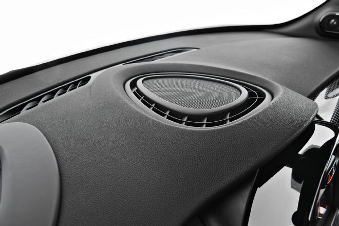

Originally Posted by TheBigNewt
I bought mine off the lot. There are a couple things I wish I had (comfort access, auto headlights). But auto climate control I'm glad I DON'T have, especially the F56 system. Sounds like a PIA, and really, the manual controls are not that tough to use IMO.
I'm also glad I got the manual A/C control.
FYI, that vent is also there in non-HK cars, although it apparently does not include the inset speaker, just blank plastic:
