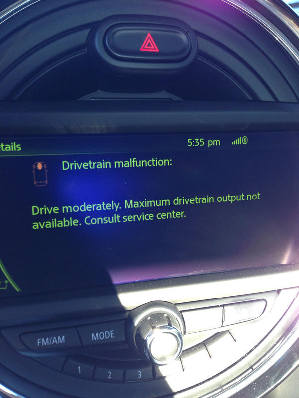

Got this lovely message the other day as well. They said it may take awhile and gave me a loaner car. At first they told me it would just need to be reprogrammed.. We will see.

That's a drag you two. Something tells me this isn't some "bugfix" or "software glitch". Sounds more mechanical to me. These are manual trannys I assume.
Looks like the reduced power mode message that was a familiar sight on some BMWs. Could mean anything. But on my old car it was most commonly associated with a bad HPFP.
I had a bad HPFP in my 2007 Mini. It never slipped out of first gear. It would intermittently fail to start on the first button push, usually first try of the day. Once it started it was fine. No warning screens. This went on for maybe a month. Finally it barely started, it just sputtered weakly and wouldn't rev when I pushed on the gas pedal. Then it wouldn't start at all. I don't think that's what's going on here.
Yes it's a 2014 MCS F56 w/ manual transmission. It has just under 3000 miles.
